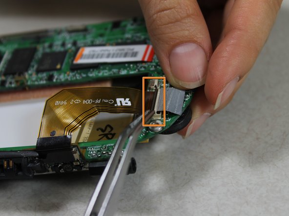

  8. Tapwave T2907US Zodiac 2 Auxiliary Port Replacement: crwdns2935265:08crwdnd2935265:01crwdnd2935265:02crwdne2935265:0 Tapwave T2907US Zodiac 2 Auxiliary Port Replacement: crwdns2935265:08crwdnd2935265:02crwdnd2935265:02crwdne2935265:0
    • Disconnect 2 brown wire-tape ends from each end of the motherboard. Gently pull straight out with tweezers.

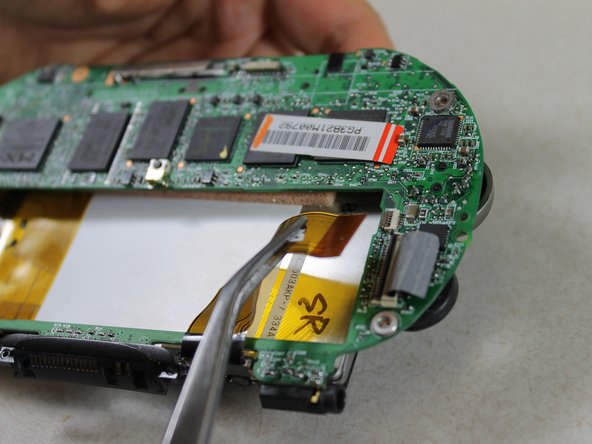

  9. Tapwave T2907US Zodiac 2 Auxiliary Port Replacement: crwdns2935265:09crwdnd2935265:01crwdnd2935265:01crwdne2935265:0
    • Pull the motherboard and screen component diagonally up and left away from the auxiliary port entrance to remove.
    • Glue connecting the auxiliary port to the casing may make it difficult to remove. Gently apply force as needed.

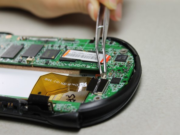

  11. Tapwave T2907US Zodiac 2 Auxiliary Port Replacement: crwdns2935265:011crwdnd2935265:01crwdnd2935265:03crwdne2935265:0 Tapwave T2907US Zodiac 2 Auxiliary Port Replacement: crwdns2935265:011crwdnd2935265:02crwdnd2935265:03crwdne2935265:0 Tapwave T2907US Zodiac 2 Auxiliary Port Replacement: crwdns2935265:011crwdnd2935265:03crwdnd2935265:03crwdne2935265:0
    • Disconnect the large brown wire-tape from the motherboard.
    • Peel the black tape back from the wire-tape using tweezers.
    • Lift the black, hinged, plastic lock with tweezers to release the wire-tape.
    • The screen and motherboard components can now be separated from each other.
