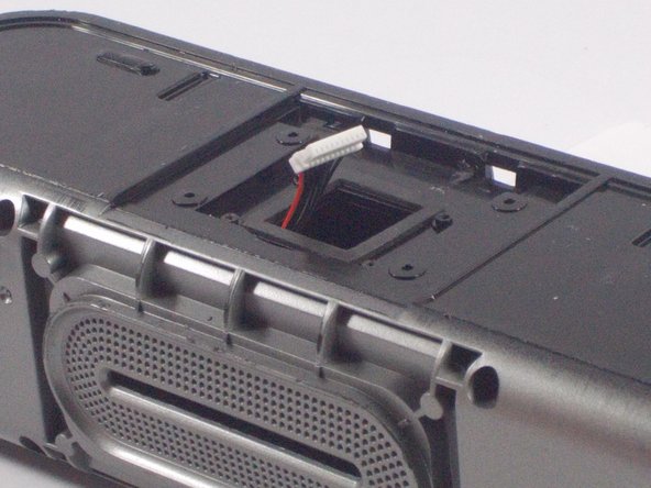

    • To remove the front grate of the speaker grab a metal spudger and go to the back corner of the device where the front panel curves around the device. Insert the spudger and ply apart the corner until clips release from panel. Repeat for the other side of the grate. When all clips are released pull grate off from the front of device
    • When working with electronics, it's important to choose a tool that's ESD-safe to avoid accidental damage to the device. The metal spudger is great when you need serious prying power, but the regular black nylon spudger or a plastic opening tool should be used whenever possible.
  2. TaoTronics TT-SK06 Control Buttons Replacement: crwdns2935265:02crwdnd2935265:01crwdnd2935265:03crwdne2935265:0 TaoTronics TT-SK06 Control Buttons Replacement: crwdns2935265:02crwdnd2935265:02crwdnd2935265:03crwdne2935265:0 TaoTronics TT-SK06 Control Buttons Replacement: crwdns2935265:02crwdnd2935265:03crwdnd2935265:03crwdne2935265:0
    • Grab two metal spudgers and insert one into the slit underneath the silver plating on the top of the device. Pry upward with the spudger until you unhook the two locks on the top. Repeat same step for the bottom of the device. When all four tabs are released, slide device out of the casing
    • Use caution when working with the metal spudger, as it can potentially damage your device.

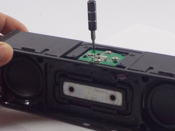

    • Locate the four, 6mm screws on the board on top of the device. Unscrew them with the PH0 bit on the screwdriver so that the board may be removed.

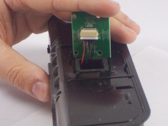

    • Using the nylon spudger, carefully remove the board from its socket. Next detach the wires from the chip to remove the board. After board is removed replace buttons.
