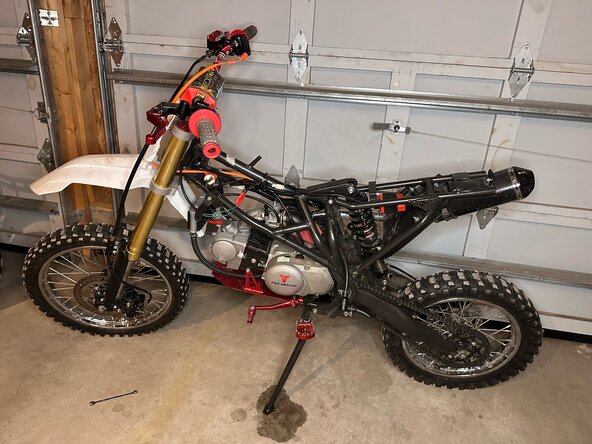

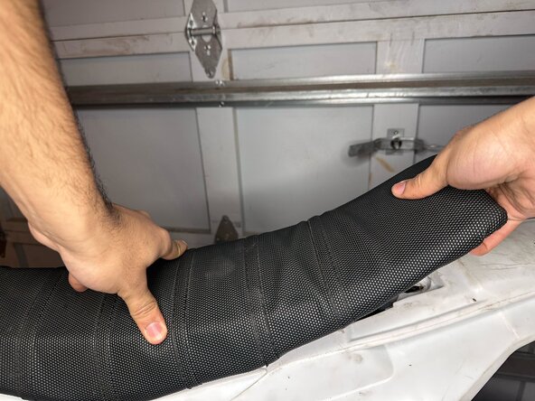

    • Stand your bike upright and secure it using the kickstand.
    • Use a 10mm socket and ratchet to unlock the seat from underneath.
    • Lift the seat off of the bike.

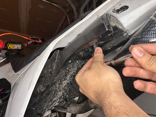

  2. Tao Tao DBX1 150cc Carburetor Replacement: crwdns2935265:02crwdnd2935265:01crwdnd2935265:03crwdne2935265:0 Tao Tao DBX1 150cc Carburetor Replacement: crwdns2935265:02crwdnd2935265:02crwdnd2935265:03crwdne2935265:0 Tao Tao DBX1 150cc Carburetor Replacement: crwdns2935265:02crwdnd2935265:03crwdnd2935265:03crwdne2935265:0

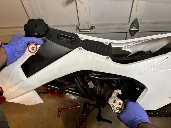

    • Use a 10mm socket and ratchet to loosen the bolts of the white outer shell of the bike.
    • Lift the white casing from the bike, remove it, and set it to the side.
    • Put the white casing down on the floor or another safe surface.

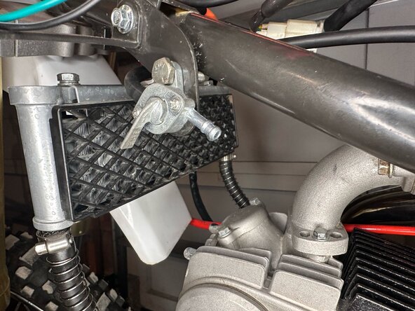

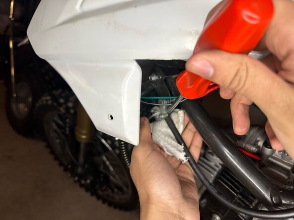

    • Turn off the fuel valve.
    • Use a flathead screwdriver to disconnect the fuel line.

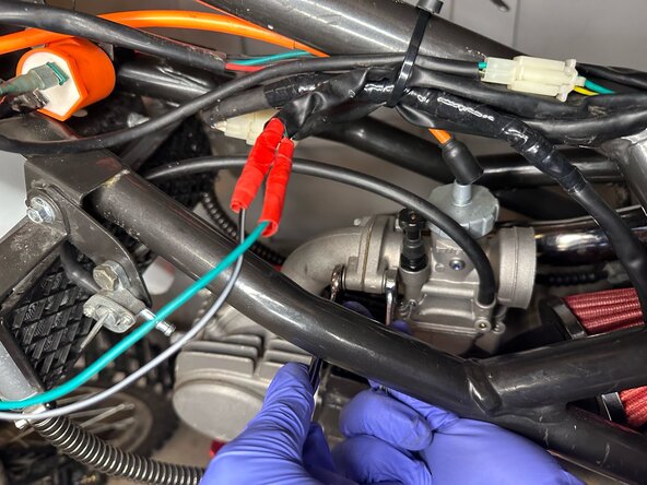

    • Twist off the air filter and intake manifold connected to the carburetor.

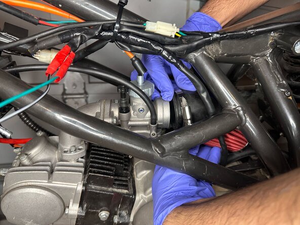

  5. Tao Tao DBX1 150cc Carburetor Replacement: crwdns2935265:05crwdnd2935265:01crwdnd2935265:03crwdne2935265:0 Tao Tao DBX1 150cc Carburetor Replacement: crwdns2935265:05crwdnd2935265:02crwdnd2935265:03crwdne2935265:0 Tao Tao DBX1 150cc Carburetor Replacement: crwdns2935265:05crwdnd2935265:03crwdnd2935265:03crwdne2935265:0

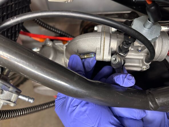

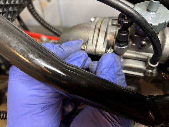

    • On the left side of the carburetor, use a 9 mm bit and driver to loosen and remove the bolts.
    • On the right side, use a 9 mm wrench to hold the corresponding nuts in place while you remove the screws.
    • Put screws aside in a safe place.

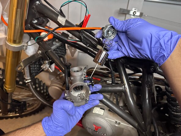

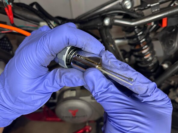

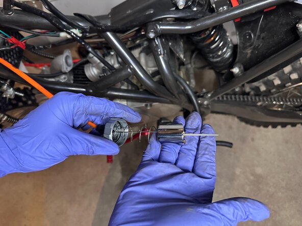

    • Twist off the carburetor's throttle cable cap and take out the inner needle.
    • Place the inner needle in a safe place to use for reassembly later.

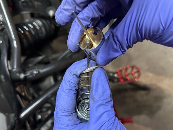

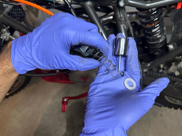

    • Bring back the inner needle and push the float valve into the spring, then take out the throttle cable through the side of the float valve.
    • Carefully take out the float valve and pivot pin.
  9. Tao Tao DBX1 150cc Carburetor Replacement: crwdns2935265:09crwdnd2935265:01crwdnd2935265:03crwdne2935265:0 Tao Tao DBX1 150cc Carburetor Replacement: crwdns2935265:09crwdnd2935265:02crwdnd2935265:03crwdne2935265:0 Tao Tao DBX1 150cc Carburetor Replacement: crwdns2935265:09crwdnd2935265:03crwdnd2935265:03crwdne2935265:0
    • Push the spring down onto the float valve.
    • Insert the throttle cable sideways through the float valve.
    • There is a line on the top side of the float valve to help guide you.
    • Now the throttle line should be connected to the float valve and pivot pin.

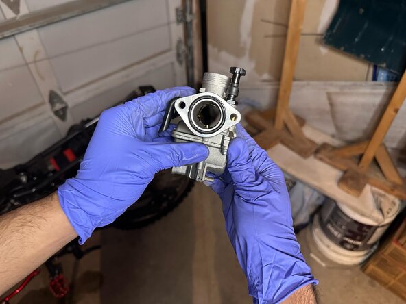

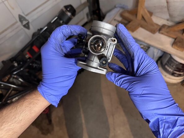

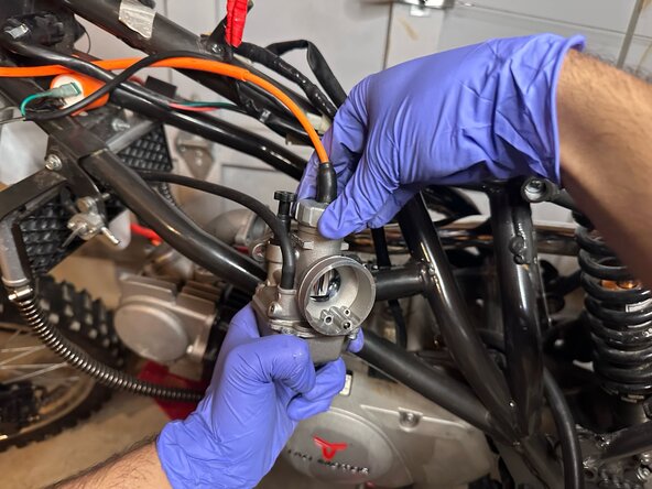

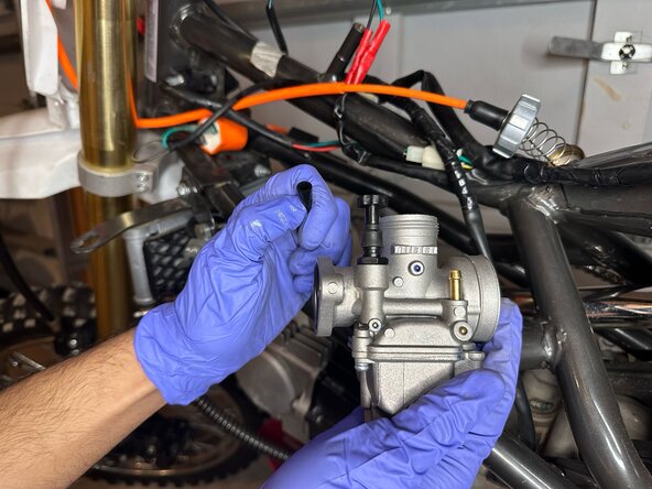

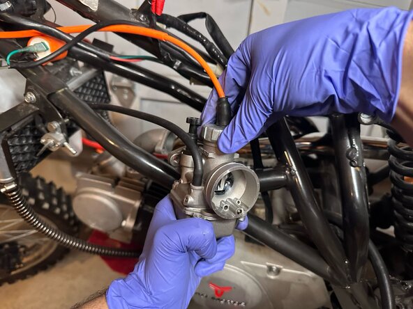

    • Inspect the carburetor and make sure it is clean.
  11. Tao Tao DBX1 150cc Carburetor Replacement: crwdns2935265:011crwdnd2935265:01crwdnd2935265:03crwdne2935265:0 Tao Tao DBX1 150cc Carburetor Replacement: crwdns2935265:011crwdnd2935265:02crwdnd2935265:03crwdne2935265:0 Tao Tao DBX1 150cc Carburetor Replacement: crwdns2935265:011crwdnd2935265:03crwdnd2935265:03crwdne2935265:0
    • Connect the gas line back onto the bike and the new carburetor.
    • Twist the throttle line shut onto the carburetor.
    • Make sure to test the throttle once it is connected to make sure there is tension.

  13. Tao Tao DBX1 150cc Carburetor Replacement: crwdns2935265:013crwdnd2935265:01crwdnd2935265:03crwdne2935265:0 Tao Tao DBX1 150cc Carburetor Replacement: crwdns2935265:013crwdnd2935265:02crwdnd2935265:03crwdne2935265:0 Tao Tao DBX1 150cc Carburetor Replacement: crwdns2935265:013crwdnd2935265:03crwdnd2935265:03crwdne2935265:0
    • Reinsert the carburetor in its original position and secure all screws and clamps to ensure a tight fit. Use the 9mm bit and the wrench to screw the carburetor back on.
    • Make sure the head gasket is in between the two sections.
  14. Tao Tao DBX1 150cc Carburetor Replacement: crwdns2935265:014crwdnd2935265:01crwdnd2935265:02crwdne2935265:0 Tao Tao DBX1 150cc Carburetor Replacement: crwdns2935265:014crwdnd2935265:02crwdnd2935265:02crwdne2935265:0
    • Replace the white outer case and seat and secure the screws with the using a 10 mm bit.
Test your dirt bike to make sure it's in working order.
