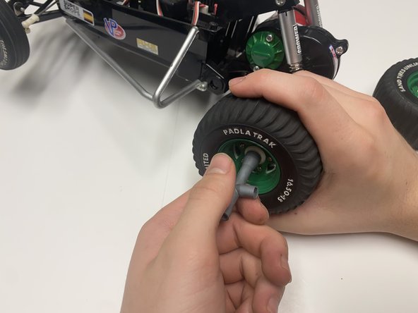

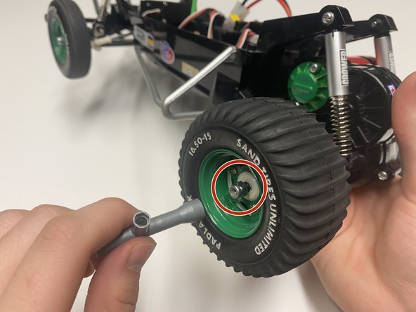

  3. Tamiya 1/10 Scale Grasshopper Brushed Motor Replacement: crwdns2935265:03crwdnd2935265:01crwdnd2935265:03crwdne2935265:0 Tamiya 1/10 Scale Grasshopper Brushed Motor Replacement: crwdns2935265:03crwdnd2935265:02crwdnd2935265:03crwdne2935265:0 Tamiya 1/10 Scale Grasshopper Brushed Motor Replacement: crwdns2935265:03crwdnd2935265:03crwdnd2935265:03crwdne2935265:0
    • Attach your box wrench with the 7mm side facing into the rim onto the hex-nut.
    • Twist the box wrench left (counter-clockwise) and unscrew the hex-nut until it comes off.
    • Hold the tire in place to prevent the tire from spinning with your box wrench.

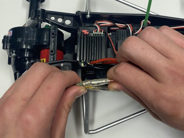

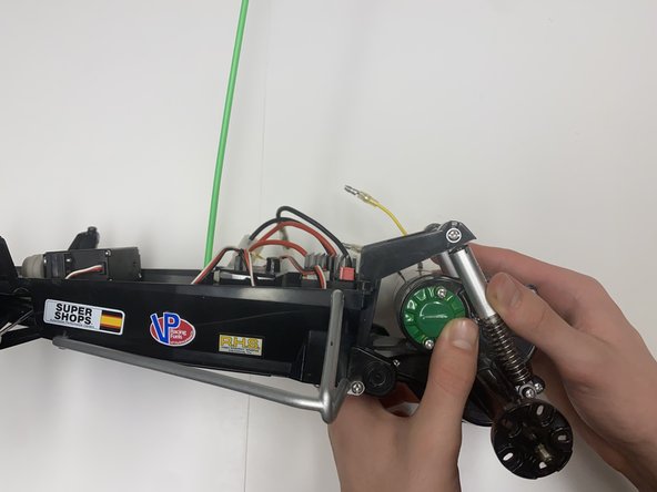

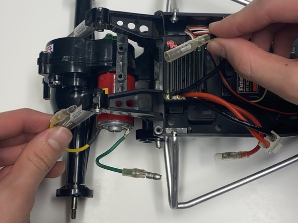

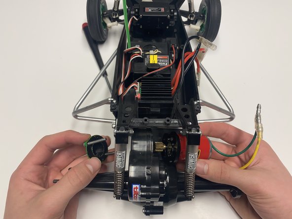

  4. Tamiya 1/10 Scale Grasshopper Brushed Motor Replacement: crwdns2935265:04crwdnd2935265:01crwdnd2935265:03crwdne2935265:0 Tamiya 1/10 Scale Grasshopper Brushed Motor Replacement: crwdns2935265:04crwdnd2935265:02crwdnd2935265:03crwdne2935265:0 Tamiya 1/10 Scale Grasshopper Brushed Motor Replacement: crwdns2935265:04crwdnd2935265:03crwdnd2935265:03crwdne2935265:0
    • Grab both the yellow and black wire as well as the green and orange wire and pull them apart.
    • The wire connectors may be difficult to remove. Do not hesitate to use more force to remove them from each other, if necessary.
    • It does not matter which wires you disconnect or connect first.

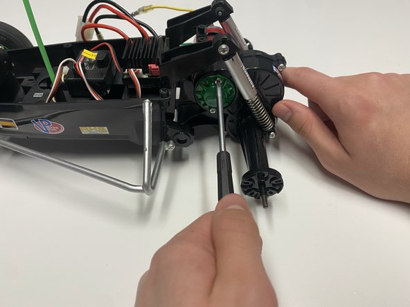

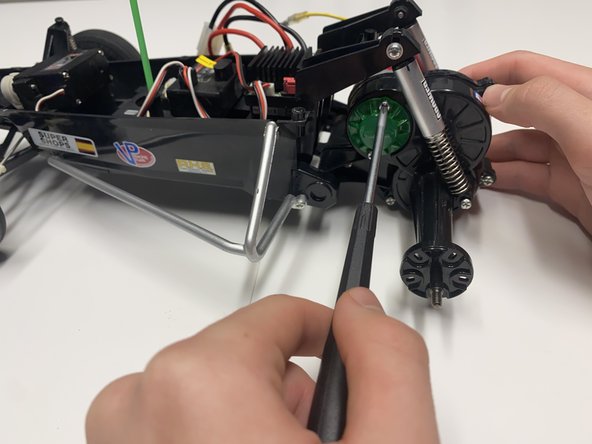

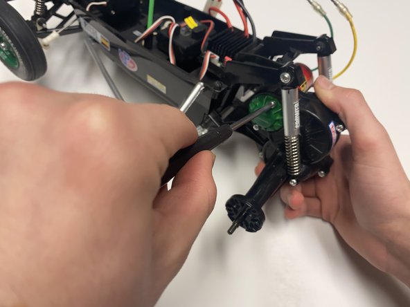

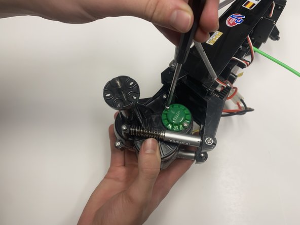

    • Loosen the first screw on the motor cover using a Phillips #00 screwdriver.
    • Loosen the bottom screw next, and you will feel the motor come loose.
    • The bottom screw has more leverage on the motor, so reverse these steps when re-assembling.
    • The motor cover is black, mine is spray-painted green.

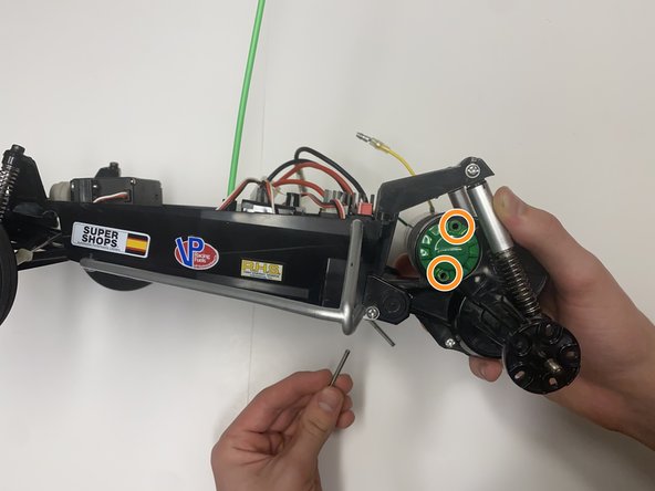

  6. Tamiya 1/10 Scale Grasshopper Brushed Motor Replacement: crwdns2935265:06crwdnd2935265:01crwdnd2935265:03crwdne2935265:0 Tamiya 1/10 Scale Grasshopper Brushed Motor Replacement: crwdns2935265:06crwdnd2935265:02crwdnd2935265:03crwdne2935265:0 Tamiya 1/10 Scale Grasshopper Brushed Motor Replacement: crwdns2935265:06crwdnd2935265:03crwdnd2935265:03crwdne2935265:0
    • Finish loosening the long screws with your Phillips #00 screwdriver.
    • Slowly pull the motor cover away from the gearbox, with the two long Phillips screws still inside the motor cover.
    • Pull the motor away from the gearbox.
    • Do not force the motor out. Let it slide into your hand if necessary to avoid damaging components or gears inside the gearbox.
