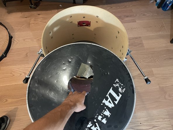

    • Remove any attachments of the kick drum.
    • This includes symbols, toms, and kick pedal.
    • Leave the leg supports of the kick drum attached.
  2. Tama 22 Inch Kick Drum Plastic Cover Replacement: crwdns2935265:02crwdnd2935265:01crwdnd2935265:02crwdne2935265:0 Tama 22 Inch Kick Drum Plastic Cover Replacement: crwdns2935265:02crwdnd2935265:02crwdnd2935265:02crwdne2935265:0

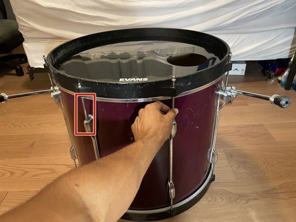

    • Turn the kick drum over so the broken plastic screen is facing up.
    • It may be beneficial to have some cushion between the floor and the drum to avoid any scratches on either object.

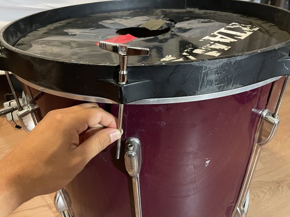

    • Use a drum key tuner to loosen the bolt by rotating counterclockwise.
    • It is not necessary to completely take the bolt out from the rim.

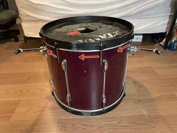

    • Repeat step 3 for all bolts that surround the rim.
    • Detach the bolts from the body of the drum; however, leave them attached and hanging loosely to the rim.
    • Rotate the rim to be sure that all bolts are free.

    • Remove the plastic microphone port from the drum.
    • This can be thrown away in the recycle bin.
    • Older models of a port screen tend to have a thinner screen without protection. Carelessness in handling may result in a severe cut.

    • Finger tighten the bolts in a clockwise motion. Do this to all of the remaining bolts that are loose.
    • Evenly tighten the bolts with the same amount of pressure.
    • For an easier experience, tighten the bolts underneath the rim rather than above the rim. See the red box location in the pictures for clarification.

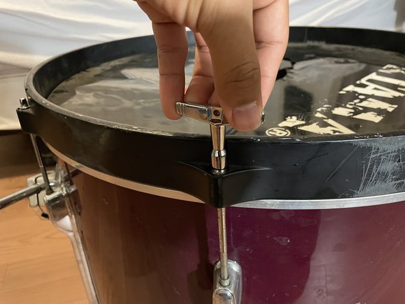

    • Use the drum key to tighten the bolts in a clockwise manner.
    • Turn the drum key one full turn (360 degrees) and move to the next bolt so that the same pressure is evenly applied to each key.
    • Turning the bolts too many times may result in severe damage on the drum and its plastic cover.
