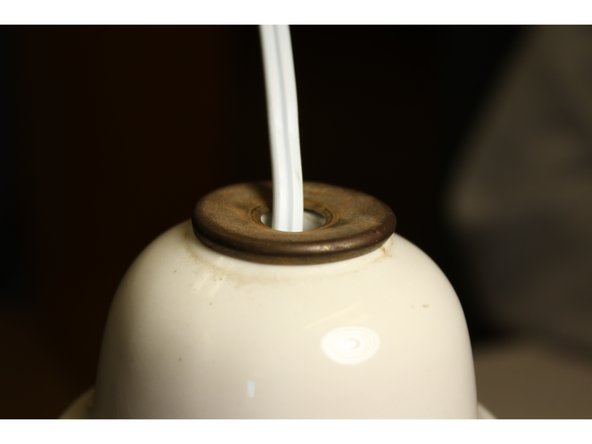

    • Thread the new wire through the hole on the bottom of the lamp. Pull it out through the top of the lamp base. (Refer the first image to get a better understanding.)
    • Place the old check ring on top of the lamp with the wire threaded through it. (Refer the second image to see the check ring.)

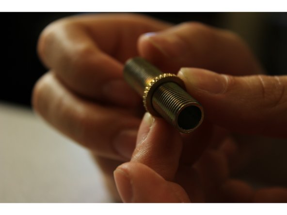

    • Place the lock nut at the end of the lamp nipple and turn it clockwise.
    • Thread the lock nut a quarter of the way through the lamp nipple.

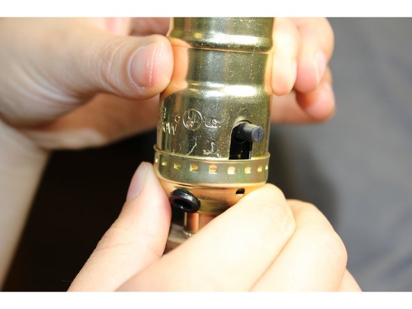

    • Place the socket shell (with paper liner) over the socket interior. Snap it into correct position. Listen for clicks to make sure that the shell is locked properly.
    • The socket should snap together to form one piece.
