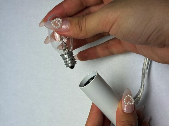

    • Grip the bulb securely and rotate it counterclockwise to loosen it from the socket.
    • Once removed, inspect the bulb for any visible damage and set it aside if it needs replacement.

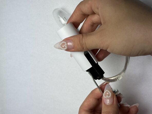

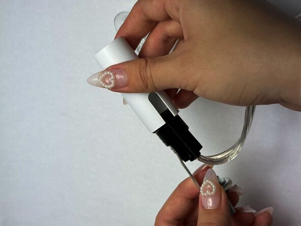

    • Take off the white cover from bottom to top.
  6. Table Lamp Bulb and Wiring Replacement: crwdns2935265:06crwdnd2935265:01crwdnd2935265:02crwdne2935265:0 Table Lamp Bulb and Wiring Replacement: crwdns2935265:06crwdnd2935265:02crwdnd2935265:02crwdne2935265:0

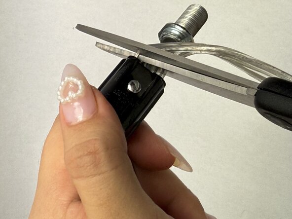

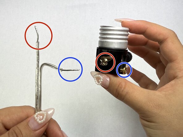

    • Cut both of the old wires with wire cutters.
  7. Table Lamp Bulb and Wiring Replacement: crwdns2935265:07crwdnd2935265:01crwdnd2935265:02crwdne2935265:0 Table Lamp Bulb and Wiring Replacement: crwdns2935265:07crwdnd2935265:02crwdnd2935265:02crwdne2935265:0

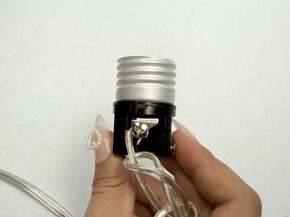

    • Take out the new wire and make sure lamp wires correlate to its terminal.
    • Neutral is marked blue, hot is marked red.
  8. Table Lamp Bulb and Wiring Replacement: crwdns2935265:08crwdnd2935265:01crwdnd2935265:01crwdne2935265:0
    • Thread the wire through the small hole under the lamp.
  9. Table Lamp Bulb and Wiring Replacement: crwdns2935265:09crwdnd2935265:01crwdnd2935265:02crwdne2935265:0 Table Lamp Bulb and Wiring Replacement: crwdns2935265:09crwdnd2935265:02crwdnd2935265:02crwdne2935265:0
    • Secure the wires to the screws using a Phillips screwdriver.
    • Tighten the screws so that the wires are secured under the screws.
  10. Table Lamp Bulb and Wiring Replacement: crwdns2935265:010crwdnd2935265:01crwdnd2935265:01crwdne2935265:0
    • Use a Phillips screwdriver to screw the wire between its correlating screw.
    • Blue is neutral, red is hot.

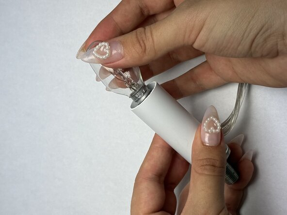

  11. Table Lamp Bulb and Wiring Replacement: crwdns2935265:011crwdnd2935265:01crwdnd2935265:01crwdne2935265:0
    • Plug the lamp in, and the bulb will light up.
