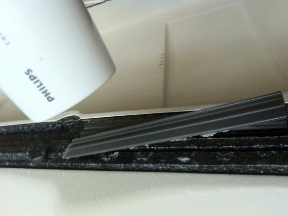

    • Using a blow dryer (or heat gun) to warm up the glues holding the old hinge in place.
    • This heating process took at least 15 minutes for me with a blow dryer.

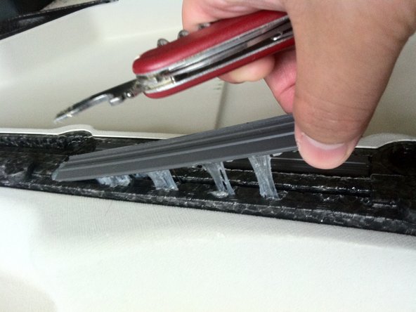

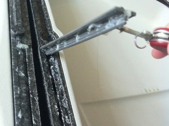

  4. TRIC Guitar Case Plastic Hinge Replacement: crwdns2935265:04crwdnd2935265:01crwdnd2935265:03crwdne2935265:0 TRIC Guitar Case Plastic Hinge Replacement: crwdns2935265:04crwdnd2935265:02crwdnd2935265:03crwdne2935265:0 TRIC Guitar Case Plastic Hinge Replacement: crwdns2935265:04crwdnd2935265:03crwdnd2935265:03crwdne2935265:0
    • As the glue starts to soften, you can pry the hinge pieces off with a tool like a Swiss Army knife. If it is still stuck on solid, keep blow drying it.

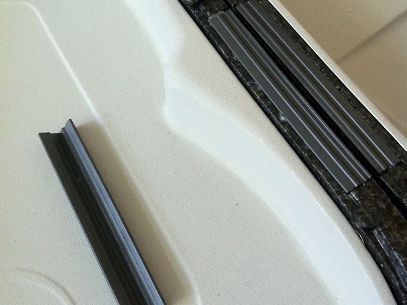

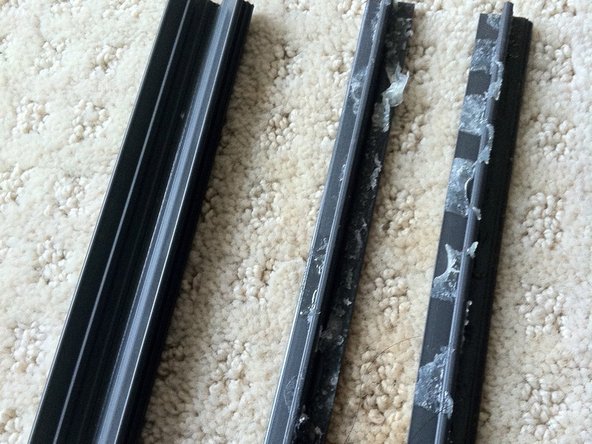

  6. TRIC Guitar Case Plastic Hinge Replacement: crwdns2935265:06crwdnd2935265:01crwdnd2935265:03crwdne2935265:0 TRIC Guitar Case Plastic Hinge Replacement: crwdns2935265:06crwdnd2935265:02crwdnd2935265:03crwdne2935265:0 TRIC Guitar Case Plastic Hinge Replacement: crwdns2935265:06crwdnd2935265:03crwdnd2935265:03crwdne2935265:0
    • Repeat for the other hinge piece: blow dry, soften the glue, pry off.
    • Hinge pieces shown side by side: new hinge on the left, old hinge on the right.

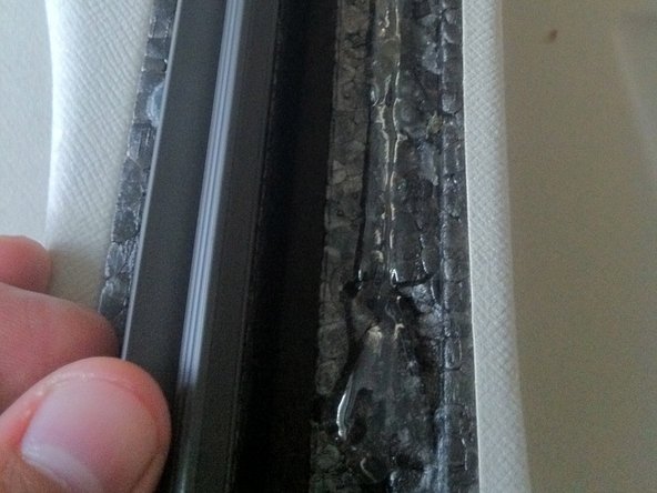

    • Use Shoe Goo to fill the cavity where the old hinge was previously. WARNING: do not use traditional hot glue gun because it dries up too fast before you even get a chance to put the new hinge on.
    • Put the new hinge in the cavities and apply some pressure to make it sink deep into the hinge cavity.

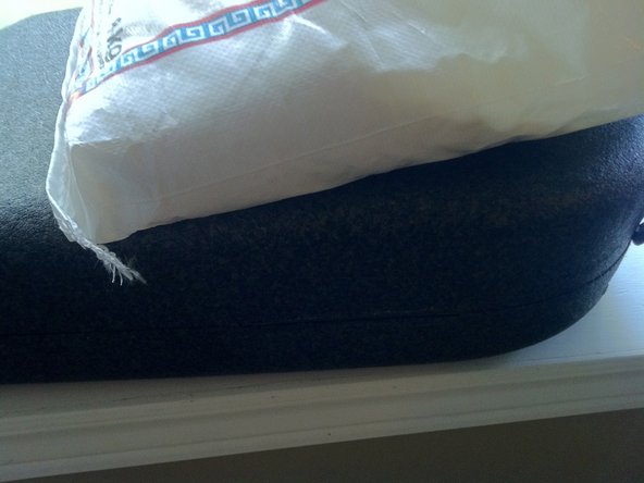

    • Fold the guitar case closed and clamp the clips to close it tight. Push the two sides to let excess Shoe Goo ooze out (that sounds so nice!).
    • Put a sack of rice or something heavy on the guitar case to let the glue solidify and dry overnight.
    • Wipe off any excess Shoe Goo that has oozed out with a paper towel or tissue.

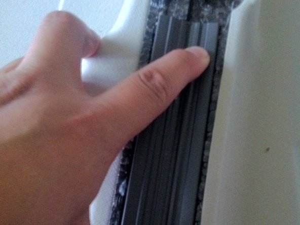

  9. TRIC Guitar Case Plastic Hinge Replacement: crwdns2935265:09crwdnd2935265:01crwdnd2935265:01crwdne2935265:0
    • After the Shoe Goo has dried up, your TRIC case is like new! So great!
    • To prevent future cracking, I may apply some sort of strong tape to the inside of the hinge.
