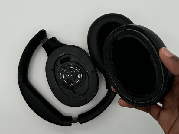

    • Firmly hold the headphone housing in one hand to hold the device steady and put the other hand on the ear pad you intend to replace.
    • Note: Do not force the ear pad to come off or you risk breaking the tabs that keep the pads in place.

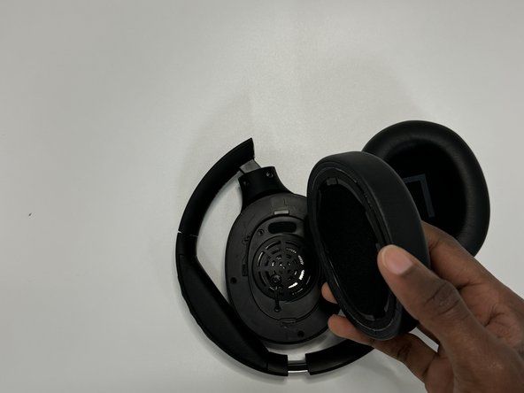

    • Twist the ear cover counterclockwise until it pops off.
    • Repeat for the other ear pad if necessary.
