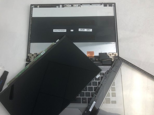

  4. TOSHIBA Satellite E45W-C4200X Screen Replacement: crwdns2935265:04crwdnd2935265:01crwdnd2935265:01crwdne2935265:0
    • Remove the remaining screws that hold the screen in place using the Phillips #1 screwdriver.
    • Carefully lift out the screen and fold on its face.
    • The screen is still attached, do not pull away from the laptop.

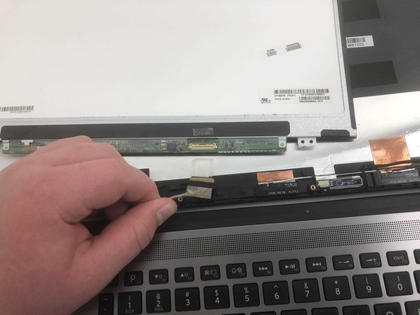

  5. TOSHIBA Satellite E45W-C4200X Screen Replacement: crwdns2935265:05crwdnd2935265:01crwdnd2935265:03crwdne2935265:0 TOSHIBA Satellite E45W-C4200X Screen Replacement: crwdns2935265:05crwdnd2935265:02crwdnd2935265:03crwdne2935265:0 TOSHIBA Satellite E45W-C4200X Screen Replacement: crwdns2935265:05crwdnd2935265:03crwdnd2935265:03crwdne2935265:0
    • Disconnect the screen from the small circuit board.
    • Gently disconnect with even pressure on both sides to prevent damage.
    • The old screen has now been completely removed.
