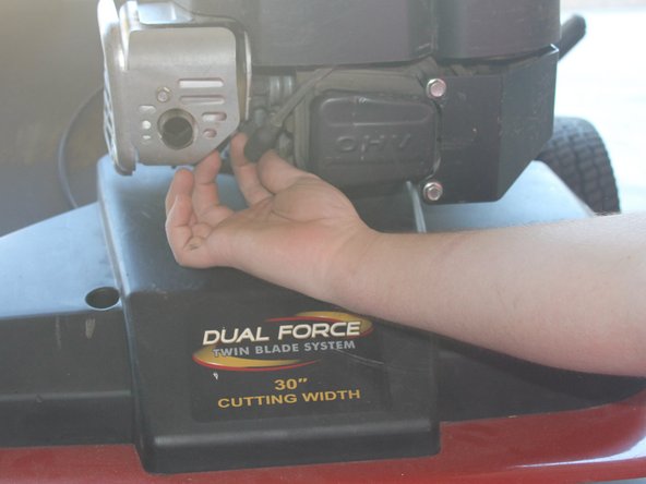

    • Remove spark plug wire and spark plug using a 5/8" socket to prevent accidental ignition of mower.

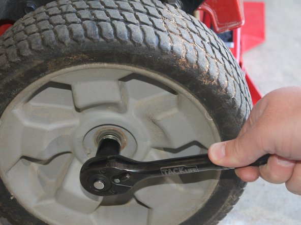

  4. TORO 30" Personal Pace TimeMaster Mower Transmission Assembly Replacement: crwdns2935265:04crwdnd2935265:01crwdnd2935265:01crwdne2935265:0
    • Remove center nut from wheel using 9/16" socket.
    • If the nut is stuck, apply WD-40 to the site and wait a few minutes.

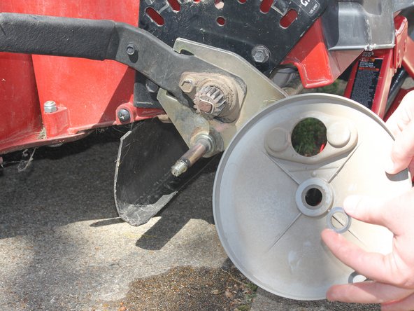

  5. TORO 30" Personal Pace TimeMaster Mower Transmission Assembly Replacement: crwdns2935265:05crwdnd2935265:01crwdnd2935265:02crwdne2935265:0 TORO 30" Personal Pace TimeMaster Mower Transmission Assembly Replacement: crwdns2935265:05crwdnd2935265:02crwdnd2935265:02crwdne2935265:0
    • Remove the wheel, washer, and plastic cover.

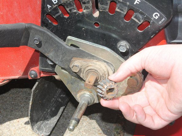

  6. TORO 30" Personal Pace TimeMaster Mower Transmission Assembly Replacement: crwdns2935265:06crwdnd2935265:01crwdnd2935265:02crwdne2935265:0 TORO 30" Personal Pace TimeMaster Mower Transmission Assembly Replacement: crwdns2935265:06crwdnd2935265:02crwdnd2935265:02crwdne2935265:0
    • Pry off the metal gear-retaining clip using a flathead screwdriver.
    • Remove gear.

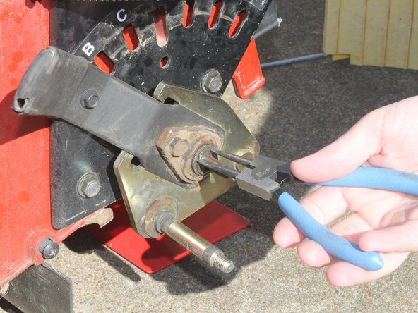

  7. TORO 30" Personal Pace TimeMaster Mower Transmission Assembly Replacement: crwdns2935265:07crwdnd2935265:01crwdnd2935265:02crwdne2935265:0 TORO 30" Personal Pace TimeMaster Mower Transmission Assembly Replacement: crwdns2935265:07crwdnd2935265:02crwdnd2935265:02crwdne2935265:0
    • Remove the snap ring using snap ring pliers.

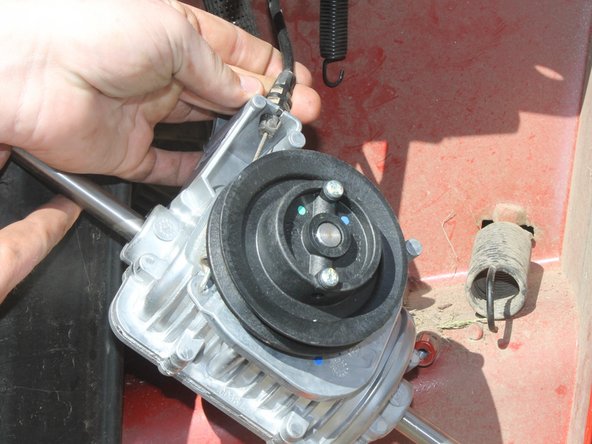

  16. TORO 30" Personal Pace TimeMaster Mower Transmission Assembly Replacement: crwdns2935265:017crwdnd2935265:01crwdnd2935265:02crwdne2935265:0 TORO 30" Personal Pace TimeMaster Mower Transmission Assembly Replacement: crwdns2935265:017crwdnd2935265:02crwdnd2935265:02crwdne2935265:0
    • Remove the drive cable from the transmission housing.
    • Needle nose pliers may help in removing the drive cable.
    • Ensure that the large spring located on the right side of the picture is disconnected from the transmission housing as well.
  17. TORO 30" Personal Pace TimeMaster Mower Transmission Assembly Replacement, Installing the new transmission: crwdns2935265:018crwdnd2935265:01crwdnd2935265:02crwdne2935265:0 TORO 30" Personal Pace TimeMaster Mower Transmission Assembly Replacement, Installing the new transmission: crwdns2935265:018crwdnd2935265:02crwdnd2935265:02crwdne2935265:0
    • Re-attach the drive cable at the cable mounting point of the new transmission.

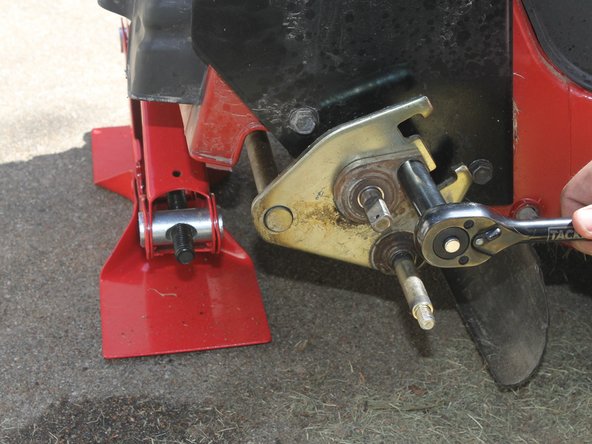

  24. TORO 30" Personal Pace TimeMaster Mower Transmission Assembly Replacement, Reattaching the Wheel: crwdns2935265:025crwdnd2935265:01crwdnd2935265:02crwdne2935265:0 TORO 30" Personal Pace TimeMaster Mower Transmission Assembly Replacement, Reattaching the Wheel: crwdns2935265:025crwdnd2935265:02crwdnd2935265:02crwdne2935265:0
    • Re-install the wheel bearing and bolt on the right-side wheel using a 1/2" socket wrench.
  25. TORO 30" Personal Pace TimeMaster Mower Transmission Assembly Replacement: crwdns2935265:026crwdnd2935265:01crwdnd2935265:01crwdne2935265:0
    • Secure a clamp between the gold rod assembly and the mower sidewall to ensure that the components added next won't slide off.

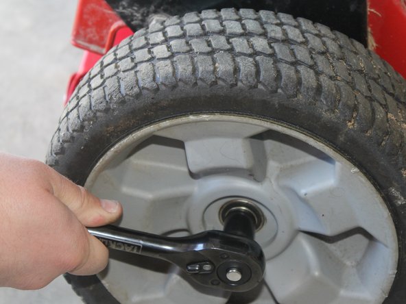

  31. TORO 30" Personal Pace TimeMaster Mower Transmission Assembly Replacement: crwdns2935265:032crwdnd2935265:01crwdnd2935265:02crwdne2935265:0 TORO 30" Personal Pace TimeMaster Mower Transmission Assembly Replacement: crwdns2935265:032crwdnd2935265:02crwdnd2935265:02crwdne2935265:0
    • Re-install wheel and use a 9/16" socket wrench to re-attach the center nut.

    • Use a 5/8" socket wrench to re-install the spark plug.
    • Re-attach the spark plug cable.

Is there supposed to be a return spring on the other end of the lever that the traction cable attaches to?
Tom P - crwdns2934203:0crwdne2934203:0
On mine, it was just throttle cable to transmission and belt drive. There are some return springs just to help stabilize the transmission housing (see steps 18-22)
Zachary Perry -
