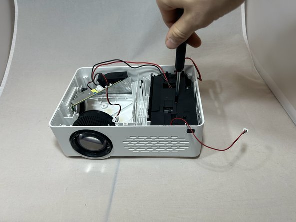

    • Turn the projector upside-down.
    • Remove the six 10.8 mm screws from the bottom of the projector using a Phillips #1 screwdriver.
    • Turn the projector back over and lift the top casing panel off the projector.

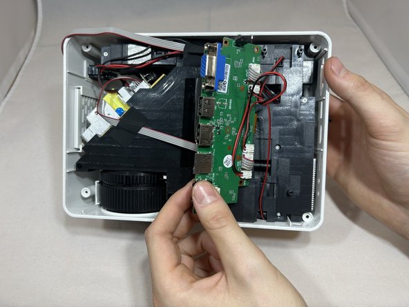

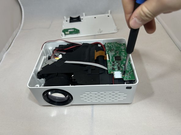

  3. TMY V08 Speaker Replacement, Speaker: crwdns2935265:03crwdnd2935265:01crwdnd2935265:03crwdne2935265:0 TMY V08 Speaker Replacement, Speaker: crwdns2935265:03crwdnd2935265:02crwdnd2935265:03crwdne2935265:0 TMY V08 Speaker Replacement, Speaker: crwdns2935265:03crwdnd2935265:03crwdnd2935265:03crwdne2935265:0
    • Remove the four 6.4 mm screws from the motherboard using a Phillips #1 screwdriver.
    • Pull back the motherboard to expose the connectors underneath.

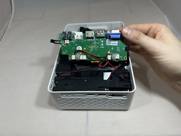

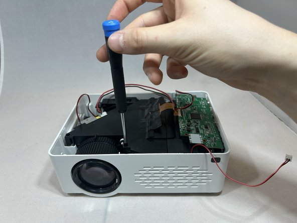

  4. TMY V08 Speaker Replacement: crwdns2935265:04crwdnd2935265:01crwdnd2935265:02crwdne2935265:0 TMY V08 Speaker Replacement: crwdns2935265:04crwdnd2935265:02crwdnd2935265:02crwdne2935265:0
    • Rotate the projector counterclockwise 90 degrees
    • Disconnect the three bundled cable connectors and the two power cable connectors from the motherboard.

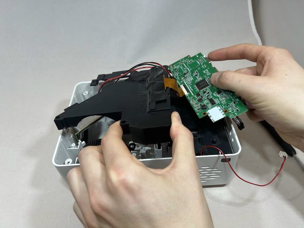

  5. TMY V08 Speaker Replacement: crwdns2935265:05crwdnd2935265:01crwdnd2935265:03crwdne2935265:0 TMY V08 Speaker Replacement: crwdns2935265:05crwdnd2935265:02crwdnd2935265:03crwdne2935265:0 TMY V08 Speaker Replacement: crwdns2935265:05crwdnd2935265:03crwdnd2935265:03crwdne2935265:0
    • Rotate the projector counterclockwise with the front facing you.
    • Remove the four 7.3 mm screws from the black cover to the left of the motherboard using a Phillips #1 screwdriver.
    • Remove the motherboard and black cover at the same time, being careful not to pull on the gold ribbon.

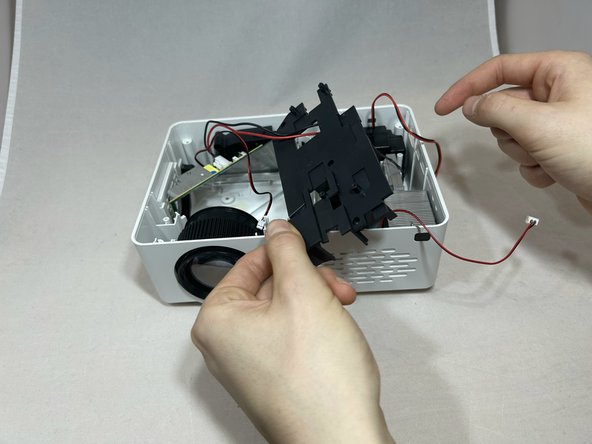

  6. TMY V08 Speaker Replacement: crwdns2935265:06crwdnd2935265:01crwdnd2935265:03crwdne2935265:0 TMY V08 Speaker Replacement: crwdns2935265:06crwdnd2935265:02crwdnd2935265:03crwdne2935265:0 TMY V08 Speaker Replacement: crwdns2935265:06crwdnd2935265:03crwdnd2935265:03crwdne2935265:0
    • Remove the five 7.3 mm screws from the black cover using a Phillips #1 screwdriver.
    • Take off the right black cover, exposing the speaker.

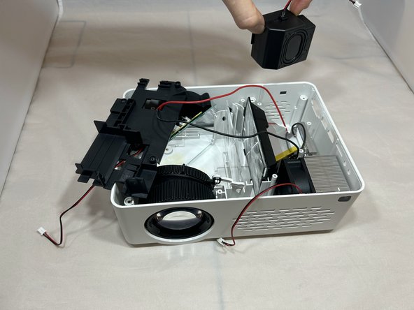

  7. TMY V08 Speaker Replacement: crwdns2935265:07crwdnd2935265:01crwdnd2935265:02crwdne2935265:0 TMY V08 Speaker Replacement: crwdns2935265:07crwdnd2935265:02crwdnd2935265:02crwdne2935265:0
    • Grasp the speaker firmly and lift up to remove.
