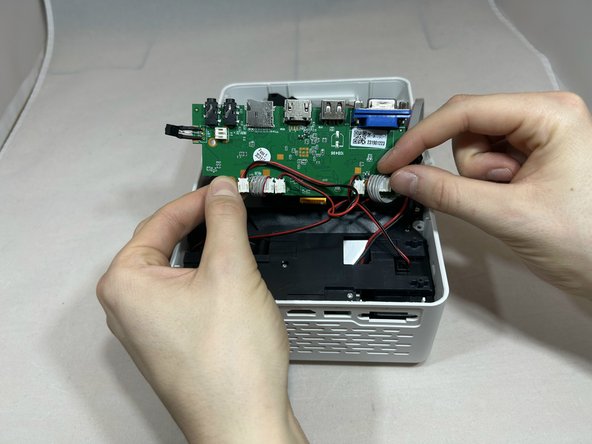

    1. TMY V08 Lens Replacement, Lens: crwdns2935265:03crwdnd2935265:01crwdnd2935265:03crwdne2935265:0 TMY V08 Lens Replacement, Lens: crwdns2935265:03crwdnd2935265:02crwdnd2935265:03crwdne2935265:0 TMY V08 Lens Replacement, Lens: crwdns2935265:03crwdnd2935265:03crwdnd2935265:03crwdne2935265:0
      • Remove the four 6.4 mm screws from the motherboard using a Phillips #1 screwdriver.
      • Pull back the motherboard to expose the connectors underneath.
    2. TMY V08 Lens Replacement: crwdns2935265:04crwdnd2935265:01crwdnd2935265:02crwdne2935265:0 TMY V08 Lens Replacement: crwdns2935265:04crwdnd2935265:02crwdnd2935265:02crwdne2935265:0
      • Rotate the projector counterclockwise 90 degrees.
      • Disconnect the three bundled cable connectors and the two power cable connectors from the motherboard.

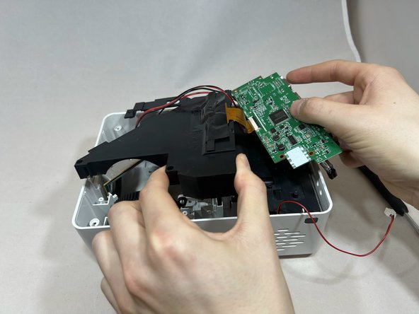

    3. TMY V08 Lens Replacement: crwdns2935265:05crwdnd2935265:01crwdnd2935265:03crwdne2935265:0 TMY V08 Lens Replacement: crwdns2935265:05crwdnd2935265:02crwdnd2935265:03crwdne2935265:0 TMY V08 Lens Replacement: crwdns2935265:05crwdnd2935265:03crwdnd2935265:03crwdne2935265:0
      • Rotate the projector counter clockwise with the front facing you.
      • Remove the four 7.3 mm screws from the black cover to the left of the motherboard using a Phillips #1 screwdriver.
      • Remove the motherboard and black cover at the same time, being careful not to pull on the gold ribbon.

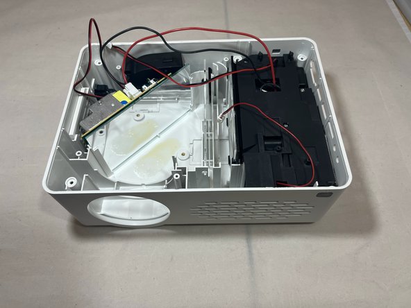

    4. TMY V08 Lens Replacement: crwdns2935265:06crwdnd2935265:01crwdnd2935265:02crwdne2935265:0 TMY V08 Lens Replacement: crwdns2935265:06crwdnd2935265:02crwdnd2935265:02crwdne2935265:0
      • Flip the projector over so the bottom is facing up.
      • Remove the two 13.9 mm screws using a Phillips #1 screwdriver.
    5. TMY V08 Lens Replacement: crwdns2935265:07crwdnd2935265:01crwdnd2935265:02crwdne2935265:0 TMY V08 Lens Replacement: crwdns2935265:07crwdnd2935265:02crwdnd2935265:02crwdne2935265:0
      • Flip the projector back over.
      • Remove the fine gauge adjustment, by lifting it out.

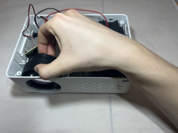

    6. TMY V08 Lens Replacement: crwdns2935265:08crwdnd2935265:01crwdnd2935265:03crwdne2935265:0 TMY V08 Lens Replacement: crwdns2935265:08crwdnd2935265:02crwdnd2935265:03crwdne2935265:0 TMY V08 Lens Replacement: crwdns2935265:08crwdnd2935265:03crwdnd2935265:03crwdne2935265:0
      • Grasp the side of the lens.
      • Pull the lens outward away from the hole while pulling upward to remove the lens.
