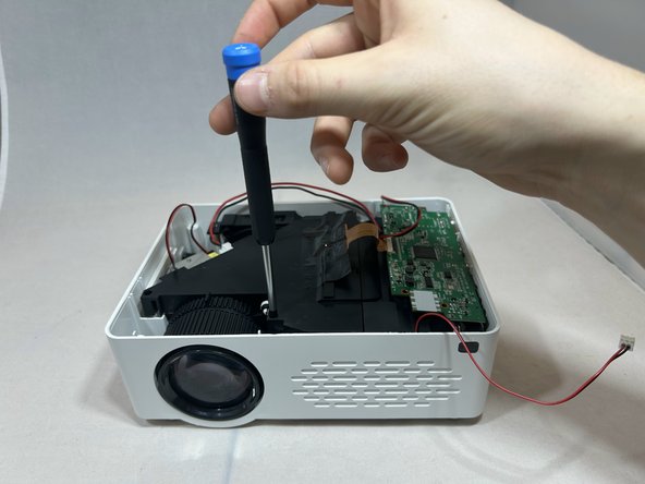

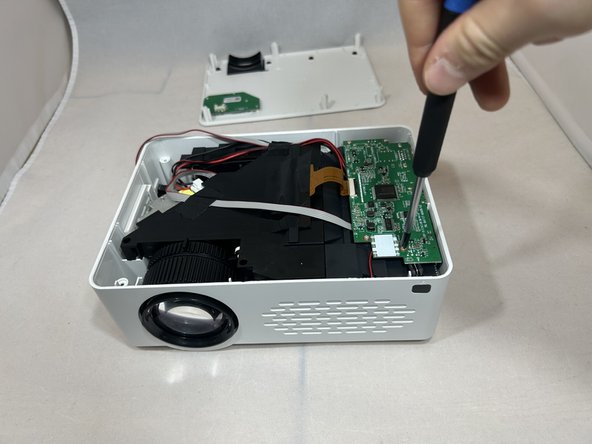

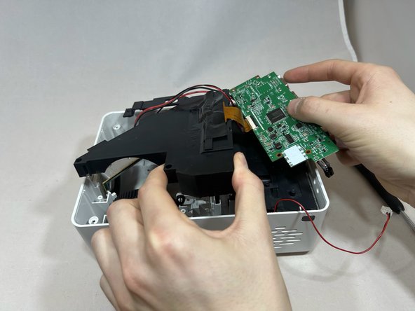

    • Turn the projector upside-down.
    • Remove the six 10.8 mm screws from the bottom of the projector using a Phillips #1 screwdriver.
    • Turn the projector back over and lift the top casing panel off the projector.

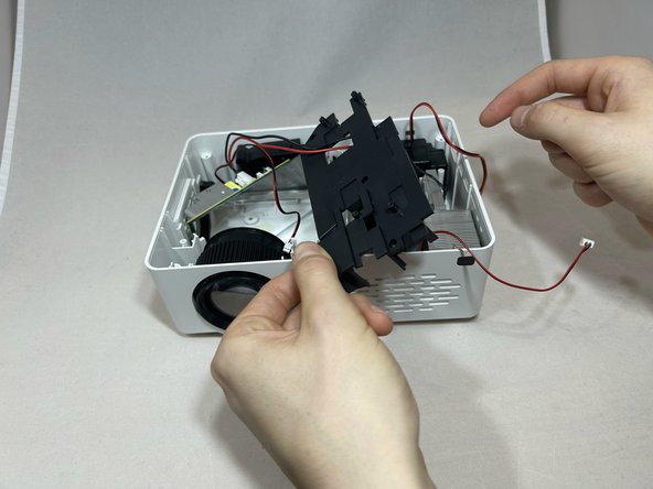

  2. TMY V08 Cooling Fan Replacement: crwdns2935265:02crwdnd2935265:01crwdnd2935265:03crwdne2935265:0 TMY V08 Cooling Fan Replacement: crwdns2935265:02crwdnd2935265:02crwdnd2935265:03crwdne2935265:0 TMY V08 Cooling Fan Replacement: crwdns2935265:02crwdnd2935265:03crwdnd2935265:03crwdne2935265:0
    • Pinch and pull the bundled cable connector from the top panel.
    • Remove the top panel from the projector.

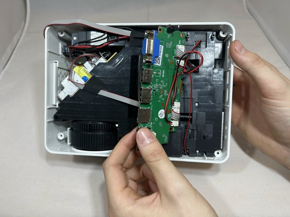

  3. TMY V08 Cooling Fan Replacement, Cooling Fan: crwdns2935265:03crwdnd2935265:01crwdnd2935265:03crwdne2935265:0 TMY V08 Cooling Fan Replacement, Cooling Fan: crwdns2935265:03crwdnd2935265:02crwdnd2935265:03crwdne2935265:0 TMY V08 Cooling Fan Replacement, Cooling Fan: crwdns2935265:03crwdnd2935265:03crwdnd2935265:03crwdne2935265:0
    • Remove the four 6.4 mm screws from the motherboard using a Phillips #1 screwdriver.
    • Pull back the motherboard to expose the connectors underneath.

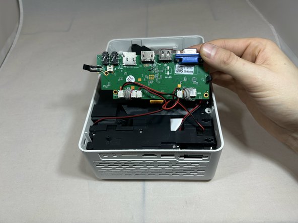

  4. TMY V08 Cooling Fan Replacement: crwdns2935265:04crwdnd2935265:01crwdnd2935265:02crwdne2935265:0 TMY V08 Cooling Fan Replacement: crwdns2935265:04crwdnd2935265:02crwdnd2935265:02crwdne2935265:0
    • Rotate the projector counterclockwise 90 degrees.
    • Disconnect the three bundled cable connectors and the two power cable connectors from the motherboard.
  5. TMY V08 Cooling Fan Replacement: crwdns2935265:05crwdnd2935265:01crwdnd2935265:03crwdne2935265:0 TMY V08 Cooling Fan Replacement: crwdns2935265:05crwdnd2935265:02crwdnd2935265:03crwdne2935265:0 TMY V08 Cooling Fan Replacement: crwdns2935265:05crwdnd2935265:03crwdnd2935265:03crwdne2935265:0
    • Rotate the projector counter clockwise with the front facing you.
    • Remove the four 7.3 mm screws from the black cover to the left of the motherboard using a Phillips #1 screwdriver.
    • Remove the motherboard and black cover at the same time, being careful not to pull on the gold ribbon.

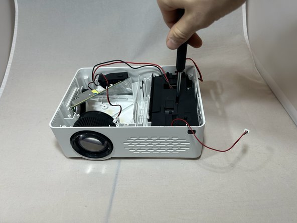

  6. TMY V08 Cooling Fan Replacement: crwdns2935265:06crwdnd2935265:01crwdnd2935265:03crwdne2935265:0 TMY V08 Cooling Fan Replacement: crwdns2935265:06crwdnd2935265:02crwdnd2935265:03crwdne2935265:0 TMY V08 Cooling Fan Replacement: crwdns2935265:06crwdnd2935265:03crwdnd2935265:03crwdne2935265:0
    • Remove the five 7.3 mm screws from the black cover using a Phillips #1 screwdriver.
    • Take off the right black cover, exposing the fan.
  7. TMY V08 Cooling Fan Replacement: crwdns2935265:07crwdnd2935265:01crwdnd2935265:01crwdne2935265:0
    • Firmly grasp and lift up the fan to remove it.
