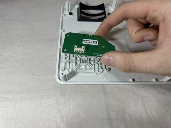

  2. TMY V08 Button Circuit Board Replacement: crwdns2935265:02crwdnd2935265:01crwdnd2935265:03crwdne2935265:0 TMY V08 Button Circuit Board Replacement: crwdns2935265:02crwdnd2935265:02crwdnd2935265:03crwdne2935265:0 TMY V08 Button Circuit Board Replacement: crwdns2935265:02crwdnd2935265:03crwdnd2935265:03crwdne2935265:0
    • Pinch and pull the bundled cable connector from the top panel.
    • Remove the top panel from the projector.

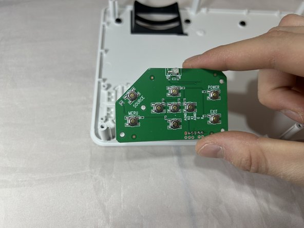

  3. TMY V08 Button Circuit Board Replacement, Button Circuit Board: crwdns2935265:03crwdnd2935265:01crwdnd2935265:03crwdne2935265:0 TMY V08 Button Circuit Board Replacement, Button Circuit Board: crwdns2935265:03crwdnd2935265:02crwdnd2935265:03crwdne2935265:0 TMY V08 Button Circuit Board Replacement, Button Circuit Board: crwdns2935265:03crwdnd2935265:03crwdnd2935265:03crwdne2935265:0
    • Remove the four 4.8 mm screws from the button circuit board beneath the top cover using a Phillips #1 screwdriver.
    • Remove the button circuit board.
