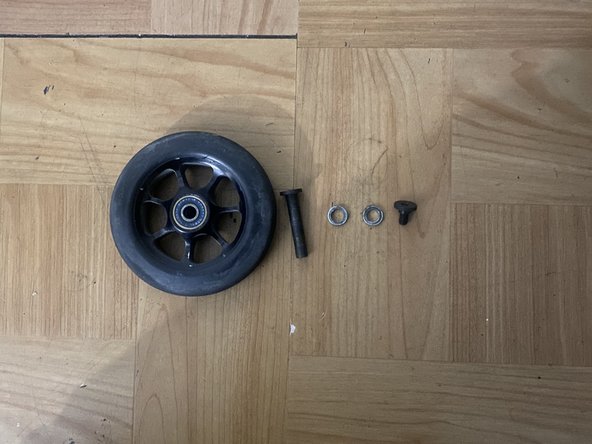

    • Flip your scooter upside down where the handle bars and wheels touch the ground to prepare the extraction of the wheel.
  2. TILT Scooter Wheel Replacement: crwdns2935265:02crwdnd2935265:01crwdnd2935265:01crwdne2935265:0
    • With the Y-tool, loosen up the screw by turning counter-clockwise.
  3. TILT Scooter Wheel Replacement: crwdns2935265:03crwdnd2935265:01crwdnd2935265:02crwdne2935265:0 TILT Scooter Wheel Replacement: crwdns2935265:03crwdnd2935265:02crwdnd2935265:02crwdne2935265:0
    • Turn the scooter to the opposite side, and insert and push the Y-tool through the same hole where the screw was removed to extract the parts.
  4. TILT Scooter Wheel Replacement: crwdns2935265:04crwdnd2935265:01crwdnd2935265:02crwdne2935265:0 TILT Scooter Wheel Replacement: crwdns2935265:04crwdnd2935265:02crwdnd2935265:02crwdne2935265:0
    • Insert the new wheel and adjust the optional 10mm hex nut to support the wheel's.
    • The 10mm hex nut helps keep the wheel from wobbling, if there was no nut then proceed to the next step.
  5. TILT Scooter Wheel Replacement: crwdns2935265:05crwdnd2935265:01crwdnd2935265:01crwdne2935265:0
    • Insert the axle from which ever side and the opposite side to help adjust the hex nuts as you insert the axle easily.
  6. TILT Scooter Wheel Replacement: crwdns2935265:06crwdnd2935265:01crwdnd2935265:01crwdne2935265:0
    • Insert the bolt and turn clockwise to tighten up the bolt.
  7. TILT Scooter Wheel Replacement: crwdns2935265:07crwdnd2935265:01crwdnd2935265:01crwdne2935265:0
    • Flip your scooter upside up and move your scooter around to detect any lose movement.
    • If there is no wobble. Congratulations, you have successful replaced your wheel!
To reassemble the wheel from the back of the scooter repeat step 1, follow the instructions similar to the front wheel.
