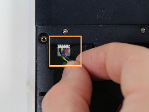

    • Use a Phillips #0 screwdriver to loosen the captive screws on the back plate of the calculator.
    • The screws do not come all the way out. Simply twist them until you are able to remove the back plate.
  2. TI-Nspire CX Battery Replacement: crwdns2935265:02crwdnd2935265:01crwdnd2935265:02crwdne2935265:0 TI-Nspire CX Battery Replacement: crwdns2935265:02crwdnd2935265:02crwdnd2935265:02crwdne2935265:0
    • Remove the back plate using the spudger or by hand.
  3. TI-Nspire CX Battery Replacement: crwdns2935265:03crwdnd2935265:01crwdnd2935265:03crwdne2935265:0 TI-Nspire CX Battery Replacement: crwdns2935265:03crwdnd2935265:02crwdnd2935265:03crwdne2935265:0 TI-Nspire CX Battery Replacement: crwdns2935265:03crwdnd2935265:03crwdnd2935265:03crwdne2935265:0
    • Carefully disconnect and remove the old battery.
    • Unhook the wire from the tab.
    • Carefully pull out the connector.
    • Grip the wire close to the top and pull away.
  4. TI-Nspire CX Battery Replacement: crwdns2935265:04crwdnd2935265:01crwdnd2935265:01crwdne2935265:0
    • Plug in the new battery.
    • Make sure to put the wire back in the same way. You should see 4 metal connections on top
  5. TI-Nspire CX Battery Replacement: crwdns2935265:05crwdnd2935265:01crwdnd2935265:01crwdne2935265:0
    • Position the new battery and tuck the wire under the tab.
  6. TI-Nspire CX Battery Replacement: crwdns2935265:06crwdnd2935265:01crwdnd2935265:01crwdne2935265:0
    • Replace the back plate and the 2 screws.
Now charge your calculator and power it up. If replacing the battery does not solve your problem, it may be a problem with your charging cord or the internal sockets.
