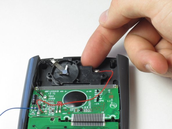

  4. TI-36X Pro Solar Panel Replacement: crwdns2935265:04crwdnd2935265:01crwdnd2935265:01crwdne2935265:0
    • Use the flat side of a spudger to remove the battery by lifting the bottom edge.
    • When inserting a new battery, check the polarity (+ or -) and insert the new battery with the + side on top.

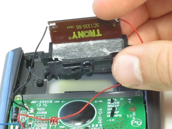

  5. TI-36X Pro Solar Panel Replacement, Solar Panel: crwdns2935265:05crwdnd2935265:01crwdnd2935265:02crwdne2935265:0 TI-36X Pro Solar Panel Replacement, Solar Panel: crwdns2935265:05crwdnd2935265:02crwdnd2935265:02crwdne2935265:0
    • Be careful not to disconnect any wires when removing parts from the calculator.
    • To detach the solar panel, use a Phillips #00 screwdriver to remove the 4.5mm screw that connects the solar panel to the calculator.
    • Once the screw has been removed, you may lift the top of the black solar panel cover with your finger and gently pull away from the green circuit board.
  6. TI-36X Pro Solar Panel Replacement: crwdns2935265:06crwdnd2935265:01crwdnd2935265:02crwdne2935265:0 TI-36X Pro Solar Panel Replacement: crwdns2935265:06crwdnd2935265:02crwdnd2935265:02crwdne2935265:0
    • Turn the black cover so the solar panel is facing you.
    • Do not use a prying motion when removing the solar panel as this might break it.
    • Insert the flat end of the spudger between the solar panel and the black cover at the corner where the red wire connects.
    • Carefully slide the spudger all the way underneath the solar panel until it detaches from the tape.
    • If the solar panel does not completely disconnect once you have fully inserted the spudger, you can gently pull or pry it the rest of the way off.
  7. TI-36X Pro Solar Panel Replacement: crwdns2935265:07crwdnd2935265:01crwdnd2935265:01crwdne2935265:0
    • De-solder and disconnect the red and black wires from the solar panel.
    • You may irreperably damage your calculator if you connect the black and red wires to the wrong sides. Red connects with the "+" and black with the "-" sign.
