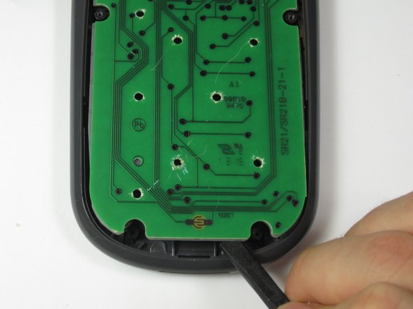

    • Be careful not to scratch the gold lines on the circuit board since it may damage the circuit.
    • Carefully chisel off the 11 circular pieces that connect the lower circuit board to the calculator.
    • When reassembling the calculator, glue the lower circuit board back in place by dabbing glue into the holes that you chiseled.

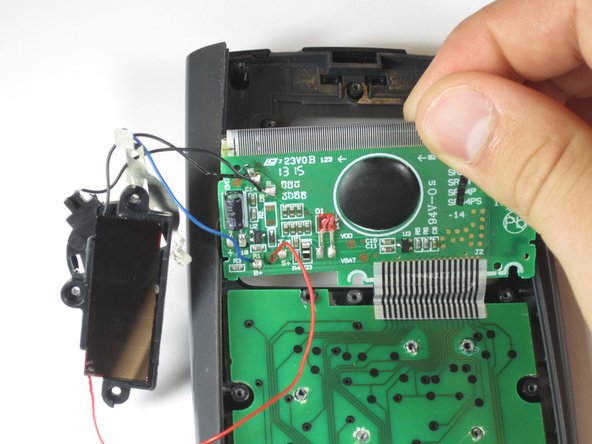

    • When removing the parts from the calculator be careful not to break any wires or ribbons. The solar panel, screen, and lower circuit board should remain connected throughout this guide.
    • Lift the top edge of the solar panel with a finger and slide it away from the circuit board to disconnect it from the calculator.
    • Carefully pry the screen out of the calculator with a prying tool or spudger.
    • Pry the lower circuit board from the calculator by inserting a prying tool between the base of the calculator and the circuit board.

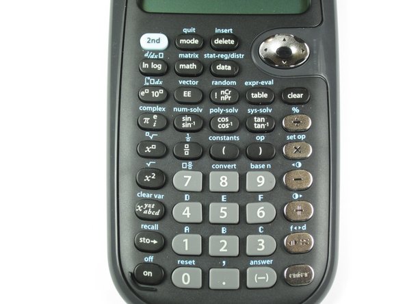

  10. TI-36X Pro Front Cover Replacement: crwdns2935265:010crwdnd2935265:01crwdnd2935265:02crwdne2935265:0 TI-36X Pro Front Cover Replacement: crwdns2935265:010crwdnd2935265:02crwdnd2935265:02crwdne2935265:0
    • Locate the button that needs replacement and lift it out of the calculator with tweezers.
    • If the buttons do fall out, use the second picture to put them back properly.
