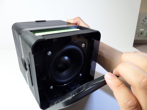

    • Pull the bottom cover of the device towards you.

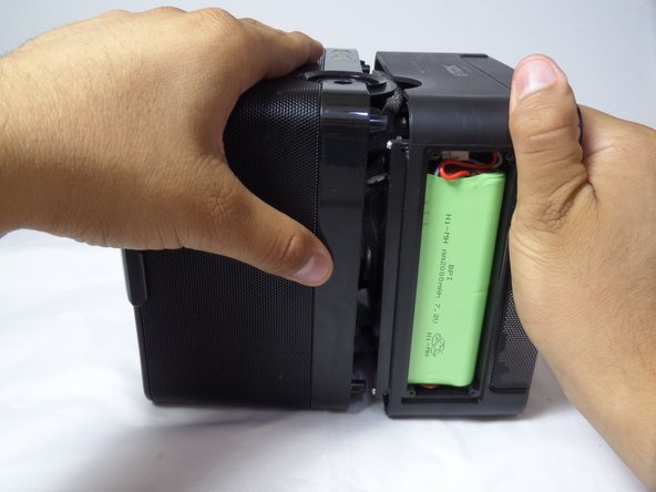

    • Use one hand to grip the device from the side of the handle, and use the other hand to grip the side of the device that contains the woofer
    • The woofer is the circular component located at the bottom of the device after the bottom cover has been removed
    • Pull apart the compartments by applying force in opposite directions.
    • Do not pull with extreme force!! There are many electrical wires inside the device that can become damaged if the bottom panel is removed without care

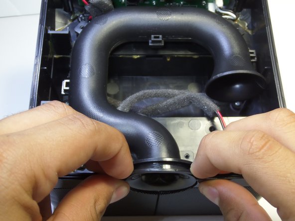

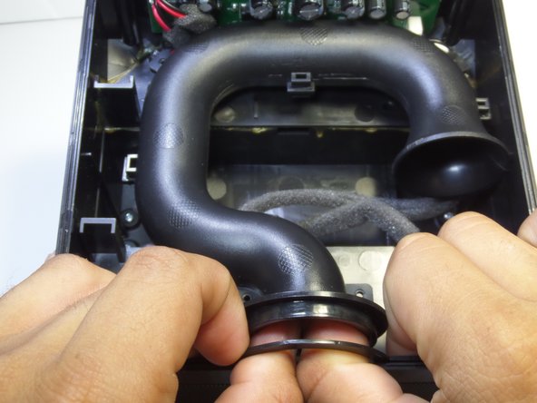

    • place your hands on each side of the air vent and then place your index finger on the thin plastic half circle that holds the vent in place.
    • Pull the plastic half circle towards you.
    • Put both of your hands inside the tube as shown and push away from you.
