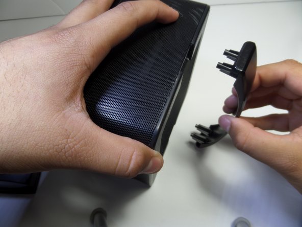

  13. TDK Life on Record Trek 360 Handle Replacement, Handle: crwdns2935265:013crwdnd2935265:01crwdnd2935265:01crwdne2935265:0
    • Remove the four 13 mm Phillips #1 screws.
  14. TDK Life on Record Trek 360 Handle Replacement: crwdns2935265:014crwdnd2935265:01crwdnd2935265:02crwdne2935265:0 TDK Life on Record Trek 360 Handle Replacement: crwdns2935265:014crwdnd2935265:02crwdnd2935265:02crwdne2935265:0
    • Use your left hand to hold the top portion of the speaker in place.
    • Using your right hand, pull the handle away from the device.
