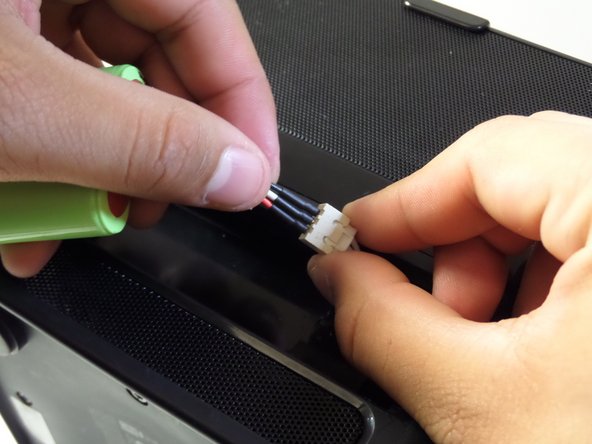

  4. TDK Life on Record Trek 360 Battery Replacement: crwdns2935265:04crwdnd2935265:01crwdnd2935265:03crwdne2935265:0 TDK Life on Record Trek 360 Battery Replacement: crwdns2935265:04crwdnd2935265:02crwdnd2935265:03crwdne2935265:0 TDK Life on Record Trek 360 Battery Replacement: crwdns2935265:04crwdnd2935265:03crwdnd2935265:03crwdne2935265:0
    • To remove the battery, use one hand to pull on the battery wires, use tweezers to pull on the connecting head of the speaker.
    • Take extreme caution when pulling. This requires some force, but pulling with extreme force can cause damage to the wire/battery/or device.

I have opened the hatch but I can’t lift the battery out. My battery seems to be glued in place…. :(
EDIT: I broke several cheap plastic spudgers, but when I finally used a metallic one, the battery pack came right out. Yes, I read that one shouldn’t use a metallic one, but this battery is dead like the dodo anyway.
