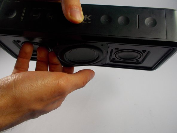

  5. TDK Life on Record A33 Speaker Replacement, Speaker: crwdns2935265:05crwdnd2935265:01crwdnd2935265:02crwdne2935265:0 TDK Life on Record A33 Speaker Replacement, Speaker: crwdns2935265:05crwdnd2935265:02crwdnd2935265:02crwdne2935265:0
    • Remove all (4) 3mm screws in the middle speaker using a Phillip's head screwdriver.
    • You can also remove the speakers on the left and right.
  6. TDK Life on Record A33 Speaker Replacement: crwdns2935265:06crwdnd2935265:01crwdnd2935265:02crwdne2935265:0 TDK Life on Record A33 Speaker Replacement: crwdns2935265:06crwdnd2935265:02crwdnd2935265:02crwdne2935265:0
    • Do not rip the wires inside the speaker when trying to open the middle speaker on the device.
    • Create an opening in the speaker by holding the device up and carefully grabbing the side of the speaker that pops out.
  7. TDK Life on Record A33 Speaker Replacement: crwdns2935265:07crwdnd2935265:01crwdnd2935265:02crwdne2935265:0 TDK Life on Record A33 Speaker Replacement: crwdns2935265:07crwdnd2935265:02crwdnd2935265:02crwdne2935265:0
    • Wear safety goggles and have something to absorb the smoke from the soldering iron just in case.
    • Do not burn the wires of the speaker.
    • Remove the solder that connects the wires to the speaker. You should be able to now remove the speaker and replace it.
