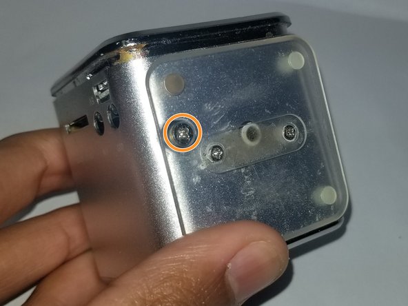

    • After the diagnosis you can proceed to unscrew the Antenna located on the side of the plastic plate.
    • Using a #1 Phillips screwdriver, remove the 1 mm screw on the side of the radio.

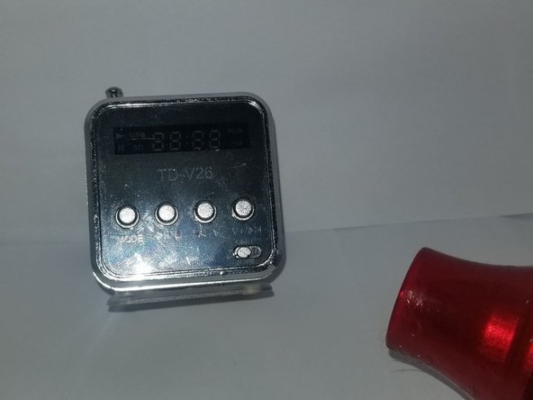

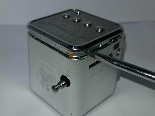

    • Using a heat gun, loosen the glue holding the face of the radio.
    • Be careful not to overheat the radio.
    • Hold the heat gun about 3 inches from the radio face while moving away from it to prevent overheating.
  5. TD-V26 Speaker and Antenna Replacement: crwdns2935265:05crwdnd2935265:01crwdnd2935265:02crwdne2935265:0 TD-V26 Speaker and Antenna Replacement: crwdns2935265:05crwdnd2935265:02crwdnd2935265:02crwdne2935265:0

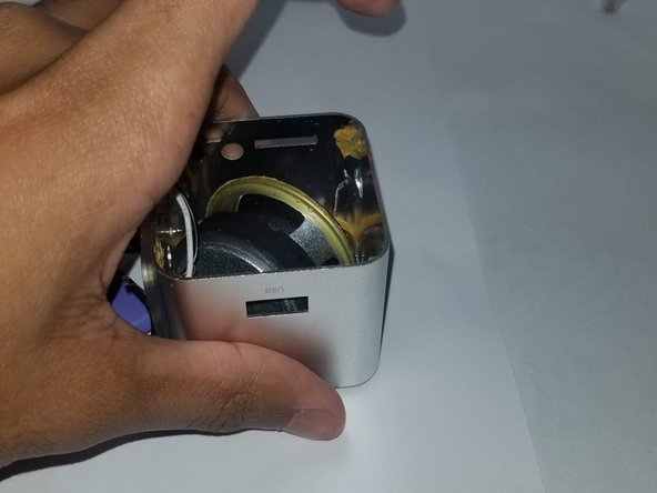

    • Use a plastic opening tool to remove the face of the radio.
    • Be sure to do this while the face is warm so the glue is still loose.
    • An easy way to remove the face is starting at a flat area and moving to the corners of the face while turning the tool to lift the face up.

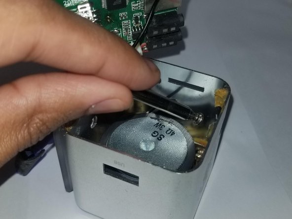

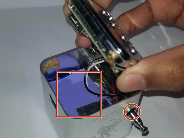

    • Remove the radio's Antenna and Battery.
    • Place the face of the radio to the side for access to the Speaker.
    • Gently pull back on the face of the radio.
    • The wires are short so be careful not to snap/tear them!

    • Place the face of the radio to the side with the battery and thread the Antenna through the inside compartment to remove it.

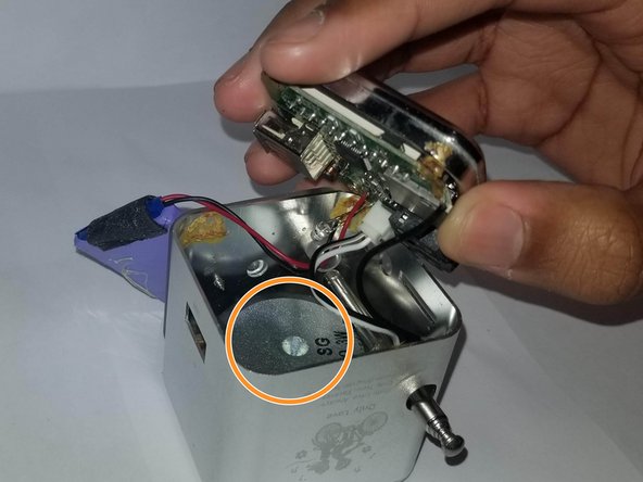

    • Pry out the Speaker from its holding position in the frame of the radio.
    • If the speaker is hard to remove use some heat to loosen the glue holding it.
  9. TD-V26 Speaker and Antenna Replacement: crwdns2935265:09crwdnd2935265:01crwdnd2935265:02crwdne2935265:0 TD-V26 Speaker and Antenna Replacement: crwdns2935265:09crwdnd2935265:02crwdnd2935265:02crwdne2935265:0
    • Unplug the Speaker Wire from the circuit by pinching the small clip and wiggling it out.
    • Do not pull the wire to remove the plug. This could break the wire.

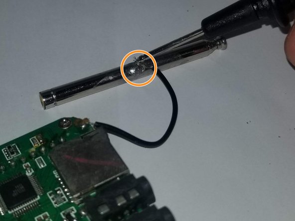

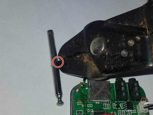

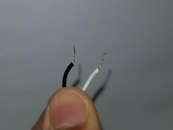

    • Cut the wires of the Speaker and the Antenna as close to the old parts as possible.
    • Cutting the wires close to the broken part ensures more working space and room for error
  11. TD-V26 Speaker and Antenna Replacement: crwdns2935265:011crwdnd2935265:01crwdnd2935265:03crwdne2935265:0 TD-V26 Speaker and Antenna Replacement: crwdns2935265:011crwdnd2935265:02crwdnd2935265:03crwdne2935265:0 TD-V26 Speaker and Antenna Replacement: crwdns2935265:011crwdnd2935265:03crwdnd2935265:03crwdne2935265:0

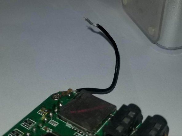

    • Strip the ends of the wires where you cut so that some wire is exposed to solder to the new parts.
  12. TD-V26 Speaker and Antenna Replacement: crwdns2935265:012crwdnd2935265:01crwdnd2935265:03crwdne2935265:0 TD-V26 Speaker and Antenna Replacement: crwdns2935265:012crwdnd2935265:02crwdnd2935265:03crwdne2935265:0 TD-V26 Speaker and Antenna Replacement: crwdns2935265:012crwdnd2935265:03crwdnd2935265:03crwdne2935265:0

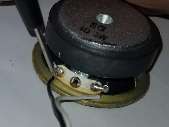

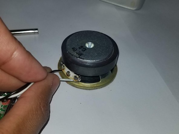

    • Solder the positive and negative terminals of the Speaker with its respective wires.
    • Both positive and negative poles should be indicated on the speaker. If not, check out the link to find the polarity of your speaker.
    • Solder the new Antenna on.

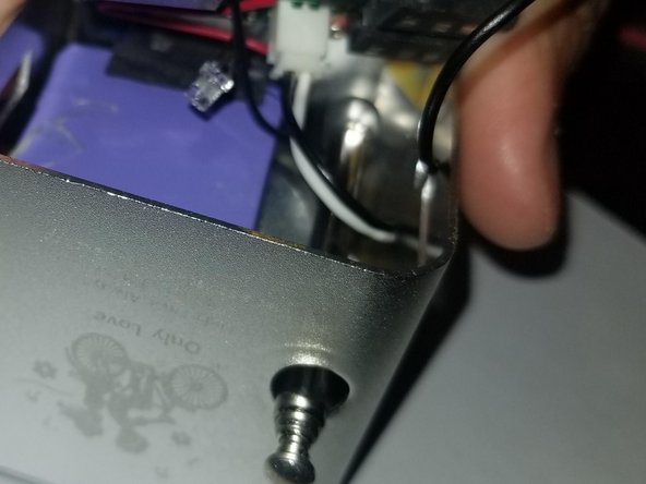

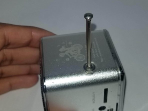

    • Take the Antenna and thread it through the hole at the top before placing it in the plastic holder at the bottom.
    • Replace the antenna screw to affix the antenna back onto the plastic base plate.
  15. TD-V26 Speaker and Antenna Replacement: crwdns2935265:015crwdnd2935265:01crwdnd2935265:02crwdne2935265:0 TD-V26 Speaker and Antenna Replacement: crwdns2935265:015crwdnd2935265:02crwdnd2935265:02crwdne2935265:0
    • Check that the Antenna can extend through the hole and place the plastic holder back in place.
    • Place the plastic ring back on to the Antenna opening.

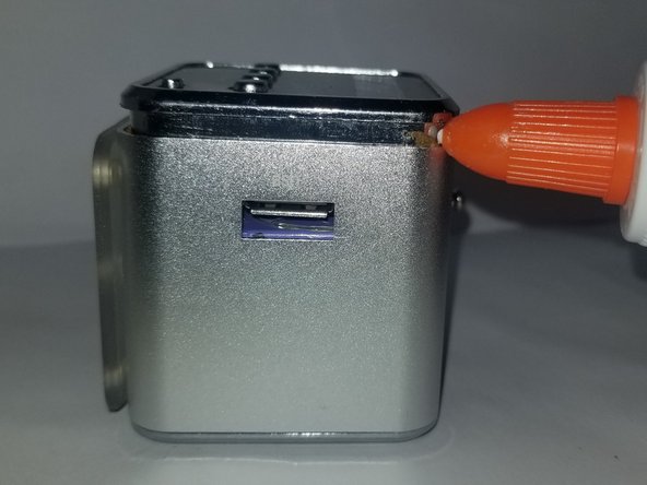

    • Glue around the main panel to secure it in place.
    • Apply some downward force until the glue starts to dry.
