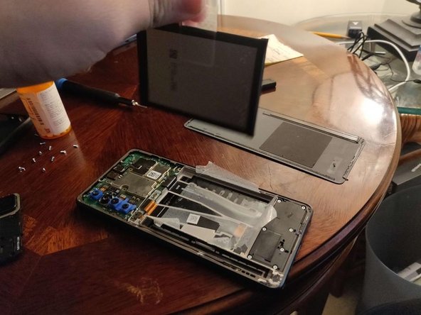

This is how to replace the battery on a TCL Stylus 5G.
      • Press and hold the Power button for 2 seconds.
      • Then, select "Power off".
    1. TCL Stylus Battery Replacement, Remove back panel: crwdns2935265:02crwdnd2935265:01crwdnd2935265:03crwdne2935265:0 TCL Stylus Battery Replacement, Remove back panel: crwdns2935265:02crwdnd2935265:02crwdnd2935265:03crwdne2935265:0 TCL Stylus Battery Replacement, Remove back panel: crwdns2935265:02crwdnd2935265:03crwdnd2935265:03crwdne2935265:0
      • Insert a jimmy tool into the casing to create a gap.
      • Then, put a plastic pick in the gap and remove the jimmy tool.
      • Finally, lift up to remove the panel.
    2. TCL Stylus Battery Replacement, Remove plastic shielding: crwdns2935265:03crwdnd2935265:01crwdnd2935265:02crwdne2935265:0 TCL Stylus Battery Replacement, Remove plastic shielding: crwdns2935265:03crwdnd2935265:02crwdnd2935265:02crwdne2935265:0
      • Remove the 10 Phillips screws holding the plastic shielding from the motherboard.
      • Then, grab a pick and put in in the slot show on picture 2.
      • You should then be able to lift the rest of it off.
    3. TCL Stylus Battery Replacement, Unplug battery: crwdns2935265:04crwdnd2935265:01crwdnd2935265:02crwdne2935265:0 TCL Stylus Battery Replacement, Unplug battery: crwdns2935265:04crwdnd2935265:02crwdnd2935265:02crwdne2935265:0
      • With your fingernail, lift up the battery connector.
    4. TCL Stylus Battery Replacement, Unpeel tape: crwdns2935265:05crwdnd2935265:01crwdnd2935265:02crwdne2935265:0 TCL Stylus Battery Replacement, Unpeel tape: crwdns2935265:05crwdnd2935265:02crwdnd2935265:02crwdne2935265:0
      • Unpeel the tape holding the battery.
    5. TCL Stylus Battery Replacement, Remove battery: crwdns2935265:06crwdnd2935265:01crwdnd2935265:02crwdne2935265:0 TCL Stylus Battery Replacement, Remove battery: crwdns2935265:06crwdnd2935265:02crwdnd2935265:02crwdne2935265:0
      • Pull on the sticker located on the middle of the left side (colored green) of the battery to remove it.
      • NOTE: The pull tab may have resistance.
