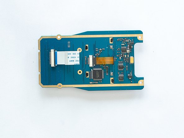

  6. TCA PRC 152A Disassembly, Display and keyboard front card: crwdns2935265:06crwdnd2935265:01crwdnd2935265:03crwdne2935265:0 TCA PRC 152A Disassembly, Display and keyboard front card: crwdns2935265:06crwdnd2935265:02crwdnd2935265:03crwdne2935265:0 TCA PRC 152A Disassembly, Display and keyboard front card: crwdns2935265:06crwdnd2935265:03crwdnd2935265:03crwdne2935265:0
    • Remove 4 screws
    • Phillips PH2
    • Disconnect the flat connector
    • Use caution when you remove the flat connector
  7. TCA PRC 152A Disassembly, Display and keyboard front card: crwdns2935265:07crwdnd2935265:01crwdnd2935265:02crwdne2935265:0 TCA PRC 152A Disassembly, Display and keyboard front card: crwdns2935265:07crwdnd2935265:02crwdnd2935265:02crwdne2935265:0

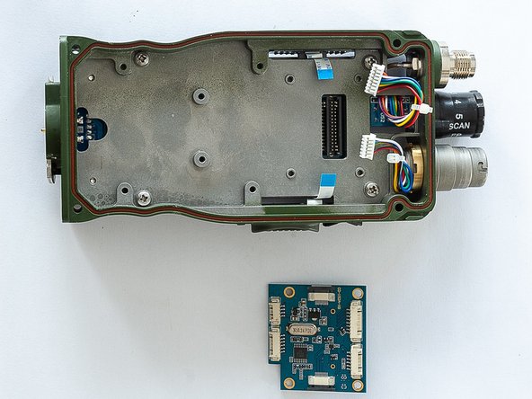

    • Place the electronics elements on ESD bags
  8. TCA PRC 152A Disassembly, Peripheral back card: crwdns2935265:08crwdnd2935265:01crwdnd2935265:03crwdne2935265:0 TCA PRC 152A Disassembly, Peripheral back card: crwdns2935265:08crwdnd2935265:02crwdnd2935265:03crwdne2935265:0 TCA PRC 152A Disassembly, Peripheral back card: crwdns2935265:08crwdnd2935265:03crwdnd2935265:03crwdne2935265:0
    • Disconnect 2 JSP connectors and 2 flat connector
    • Remove 4 screws
    • Phillips PH2
    • Carefully disconect the connectors and the board

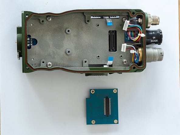

  9. TCA PRC 152A Disassembly, Mainboard removal: crwdns2935265:09crwdnd2935265:01crwdnd2935265:03crwdne2935265:0 TCA PRC 152A Disassembly, Mainboard removal: crwdns2935265:09crwdnd2935265:02crwdnd2935265:03crwdne2935265:0 TCA PRC 152A Disassembly, Mainboard removal: crwdns2935265:09crwdnd2935265:03crwdnd2935265:03crwdne2935265:0
    • Remove 4 screws
    • Phillips PH2
    • Disconnect the antenna connector
    • Carefully removing the mainboard
    • Thermal paste between the card and the body

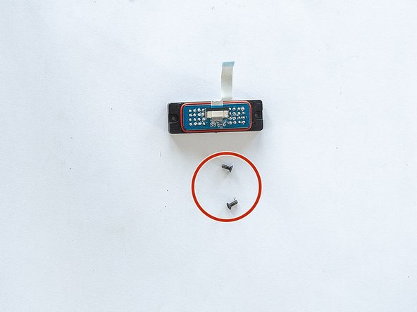

  10. TCA PRC 152A Disassembly, Side connectors removal: crwdns2935265:010crwdnd2935265:01crwdnd2935265:02crwdne2935265:0 TCA PRC 152A Disassembly, Side connectors removal: crwdns2935265:010crwdnd2935265:02crwdnd2935265:02crwdne2935265:0
    • Remove 2 screws
    • Phillips PH1
    • Carefully removing the connector

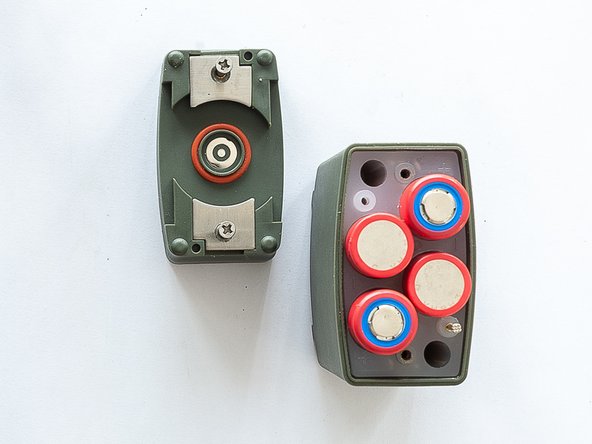

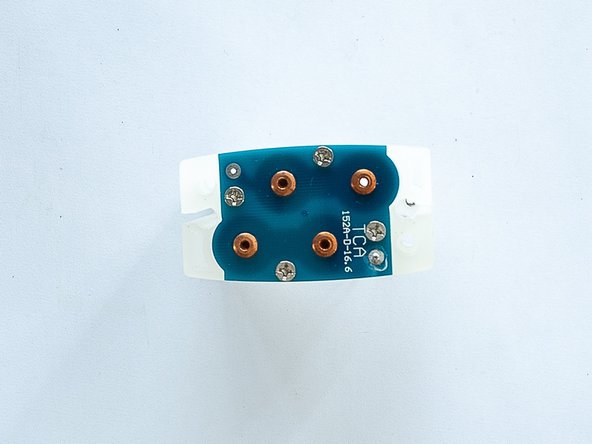

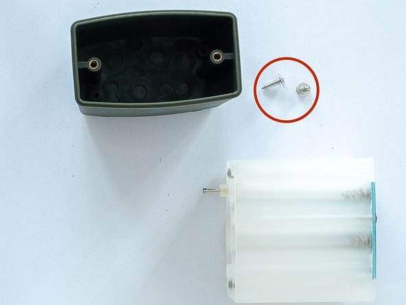

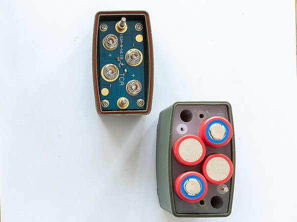

  11. TCA PRC 152A Disassembly, Batterybloc dissasembly: crwdns2935265:011crwdnd2935265:01crwdnd2935265:03crwdne2935265:0 TCA PRC 152A Disassembly, Batterybloc dissasembly: crwdns2935265:011crwdnd2935265:02crwdnd2935265:03crwdne2935265:0 TCA PRC 152A Disassembly, Batterybloc dissasembly: crwdns2935265:011crwdnd2935265:03crwdnd2935265:03crwdne2935265:0
    • Remove 2 screws
    • Phillips PH3
    • Remove the topcover, take care about short circuit
  12. TCA PRC 152A Disassembly, Batterybloc dissasembly: crwdns2935265:012crwdnd2935265:01crwdnd2935265:03crwdne2935265:0 TCA PRC 152A Disassembly, Batterybloc dissasembly: crwdns2935265:012crwdnd2935265:02crwdnd2935265:03crwdne2935265:0 TCA PRC 152A Disassembly, Batterybloc dissasembly: crwdns2935265:012crwdnd2935265:03crwdnd2935265:03crwdne2935265:0
    • Remove battery stick (18650 Panasonic)
    • Remove 2 screws
    • Phillips PH3
    • Take off the inner white retainer
