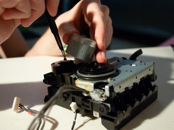

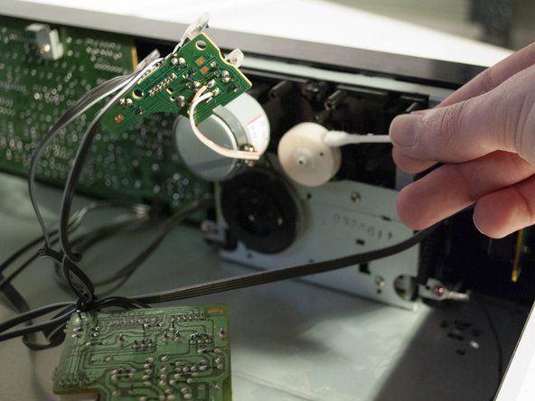

    • Remove the spindle belt by gripping it and sliding it over the wheel.
    • Clean any residue on the wheels with isopropyl alcohol and a Q-tip.

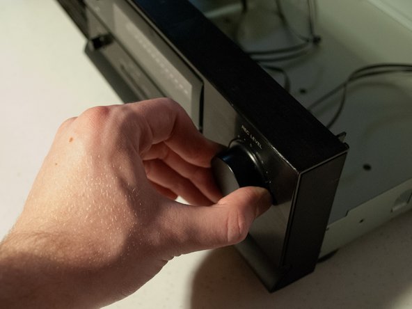

    • Remove the cassette door by gripping it from the top and bottom, and sliding upward.
    • Remove the bias, balance, and record level knobs by firmly grasping them from both sides and pulling outward.
    • Make a note of what setting the knobs are currently set to. They are keyed and can only be attached one way.

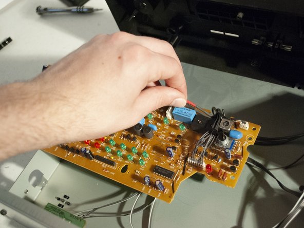

  5. TC-FX170 Belt Replacement: crwdns2935265:05crwdnd2935265:01crwdnd2935265:03crwdne2935265:0 TC-FX170 Belt Replacement: crwdns2935265:05crwdnd2935265:02crwdnd2935265:03crwdne2935265:0 TC-FX170 Belt Replacement: crwdns2935265:05crwdnd2935265:03crwdnd2935265:03crwdne2935265:0

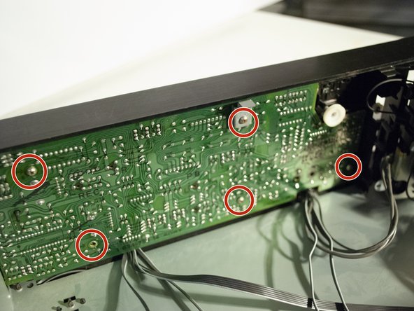

    • Undo the five Phillips #1 screws that hold the front IO board in place.
    • Unplug the two cables for the cassette mechanism from the board by gripping them from the sides and pulling outward.

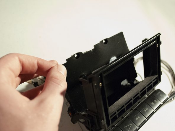

  6. TC-FX170 Belt Replacement: crwdns2935265:06crwdnd2935265:01crwdnd2935265:02crwdne2935265:0 TC-FX170 Belt Replacement: crwdns2935265:06crwdnd2935265:02crwdnd2935265:02crwdne2935265:0

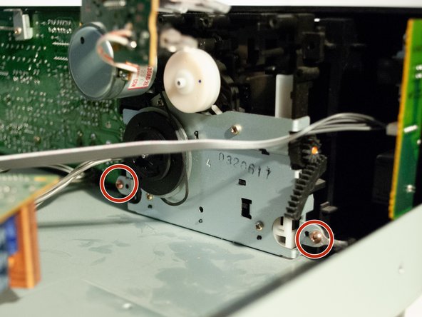

    • Remove the four Phillips #1 screws keeping the cassette mechanism in place and lift it outward.

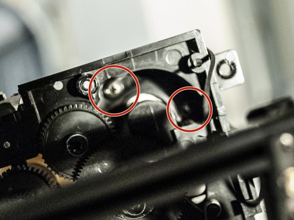

    • Remove the motor by unscrewing the two Phillips #1 screws within the mechanism. Pull it out from the rear of the mechanism.
    • Discard the main motor belt. Clean any residue it may have left.

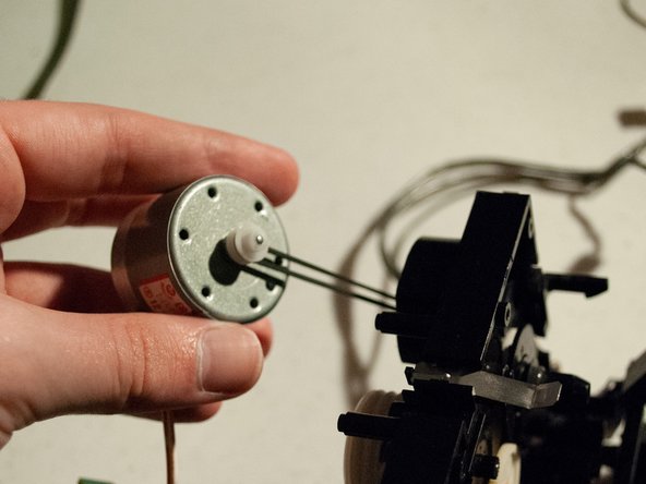

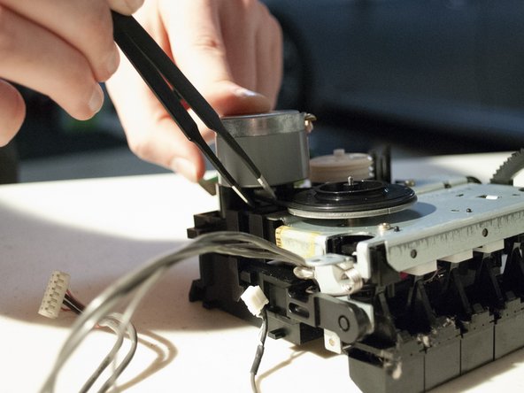

    • Use a pair of tweezers to wrap the replacement belt over the large end of the black wheel.
    • Orient the motor such that the solder joints hang over the rear of the cassette mechanism, hold the replacement belt back with tweezers and slide the motor back into place on top of it. Slowly slide the belt back toward the motor, aligning the belt to the motor's spindle.

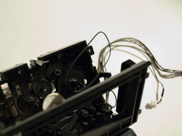

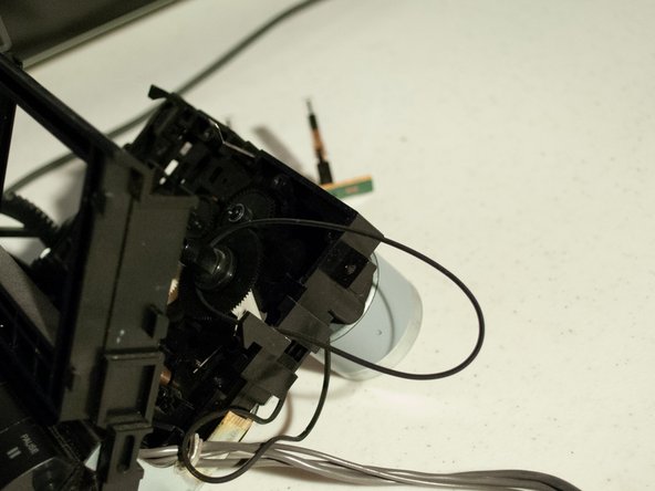

  10. TC-FX170 Belt Replacement: crwdns2935265:010crwdnd2935265:01crwdnd2935265:02crwdne2935265:0 TC-FX170 Belt Replacement: crwdns2935265:010crwdnd2935265:02crwdnd2935265:02crwdne2935265:0
    • Using a pair of tweezers, loop the tape counter belt around the spindle and leave the other end off the side of the mechanism.
