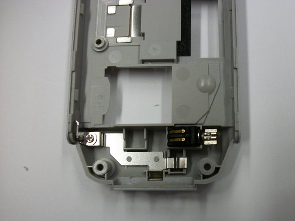

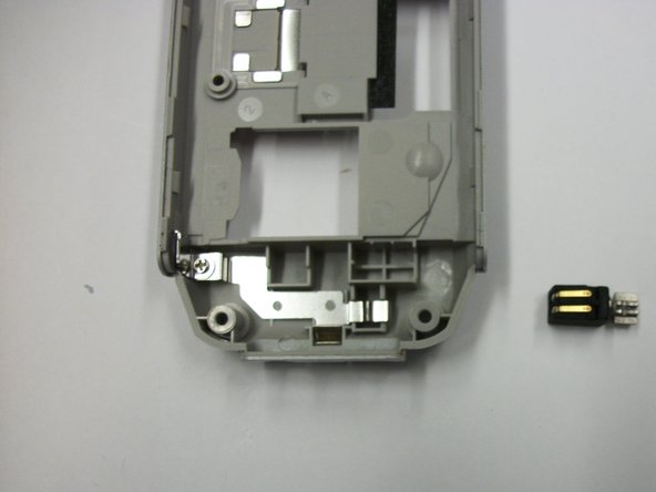

  6. T-Mobile SDA (HTC Tornado) Vibrator Replacement, Vibrator: crwdns2935265:06crwdnd2935265:01crwdnd2935265:03crwdne2935265:0 T-Mobile SDA (HTC Tornado) Vibrator Replacement, Vibrator: crwdns2935265:06crwdnd2935265:02crwdnd2935265:03crwdne2935265:0 T-Mobile SDA (HTC Tornado) Vibrator Replacement, Vibrator: crwdns2935265:06crwdnd2935265:03crwdnd2935265:03crwdne2935265:0
    • Place the rear phone casing on a flat surface so that the copper wire is facing up.
    • Locate the small black box in the bottom right of the phone. This is the vibration device.
    • Pull the vibration device out using two fingers.
