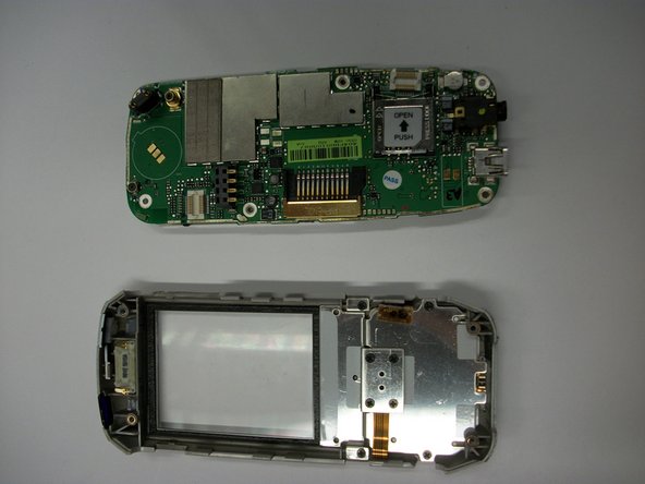

  5. T-Mobile SDA (HTC Tornado) Keypad Replacement: crwdns2935265:05crwdnd2935265:01crwdnd2935265:03crwdne2935265:0 T-Mobile SDA (HTC Tornado) Keypad Replacement: crwdns2935265:05crwdnd2935265:02crwdnd2935265:03crwdne2935265:0 T-Mobile SDA (HTC Tornado) Keypad Replacement: crwdns2935265:05crwdnd2935265:03crwdnd2935265:03crwdne2935265:0
    • Using the T5 or T6 screwdriver, remove the six screws from the back of the phone, as shown in the first image.
    • Remove the back half of the phone by using the plastic opening tool to pry apart the top half from the bottom half. Wedge the plastic opening tool tool around the edge of the phone to dislocate the tabs.
    • Once the tabs are dislocated, pull the back of the phone apart from the front half.

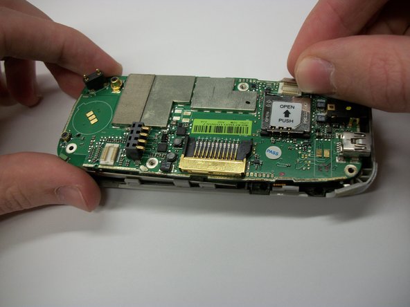

  6. T-Mobile SDA (HTC Tornado) Keypad Replacement, Circuit Board: crwdns2935265:06crwdnd2935265:01crwdnd2935265:03crwdne2935265:0 T-Mobile SDA (HTC Tornado) Keypad Replacement, Circuit Board: crwdns2935265:06crwdnd2935265:02crwdnd2935265:03crwdne2935265:0 T-Mobile SDA (HTC Tornado) Keypad Replacement, Circuit Board: crwdns2935265:06crwdnd2935265:03crwdnd2935265:03crwdne2935265:0
    • On the rear phone casing, locate the ribbon cable tab and connector next to the SIM card port.
    • Gently pull up on the tab to disconnect it from the connector.
    • Carefully remove the circuit board from the phone casing.

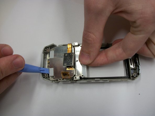

    • Hold the front of the phone face down.
    • Using a T6 screwdriver bit, loosen the eight screws holding the keypad protector in place.
    • Loosen the keypad connector by lifting the rectangular plate up with one finger.

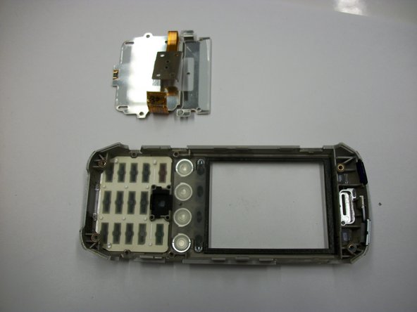

  8. T-Mobile SDA (HTC Tornado) Keypad Replacement: crwdns2935265:08crwdnd2935265:01crwdnd2935265:03crwdne2935265:0 T-Mobile SDA (HTC Tornado) Keypad Replacement: crwdns2935265:08crwdnd2935265:02crwdnd2935265:03crwdne2935265:0 T-Mobile SDA (HTC Tornado) Keypad Replacement: crwdns2935265:08crwdnd2935265:03crwdnd2935265:03crwdne2935265:0
    • Use the plastic opening tool to loosen the keypad protector from the faceplate.
    • Once the protector is loosened, use the plastic opening tool to slide the keypad protector towards the screen while pulling on it with two fingers.
    • Remove the keypad protector and connector from the faceplate.

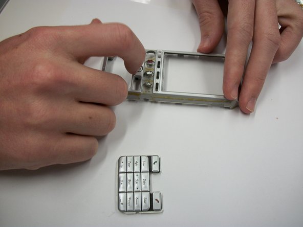

  9. T-Mobile SDA (HTC Tornado) Keypad Replacement: crwdns2935265:09crwdnd2935265:01crwdnd2935265:02crwdne2935265:0 T-Mobile SDA (HTC Tornado) Keypad Replacement: crwdns2935265:09crwdnd2935265:02crwdnd2935265:02crwdne2935265:0
    • Hold the phone with the keypad facing up and gently push on the keypad with one finger to dislodge it from phone.
    • Place the keypad to the side.
