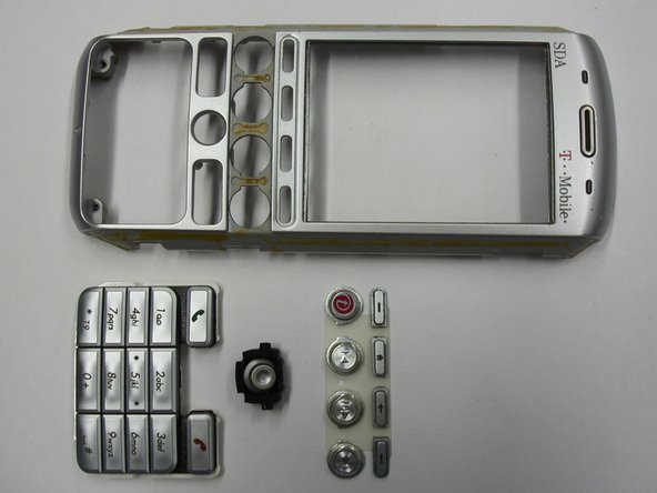

    • Hold the front of the phone face down.
    • Using a T6 screwdriver bit, loosen the eight screws holding the keypad protector in place.
    • Loosen the keypad connector by lifting the rectangular plate up with one finger.
  8. T-Mobile SDA (HTC Tornado) Front Faceplate Replacement: crwdns2935265:08crwdnd2935265:01crwdnd2935265:03crwdne2935265:0 T-Mobile SDA (HTC Tornado) Front Faceplate Replacement: crwdns2935265:08crwdnd2935265:02crwdnd2935265:03crwdne2935265:0 T-Mobile SDA (HTC Tornado) Front Faceplate Replacement: crwdns2935265:08crwdnd2935265:03crwdnd2935265:03crwdne2935265:0
    • Use the plastic opening tool to loosen the keypad protector from the faceplate.
    • Once the protector is loosened, use the plastic opening tool to slide the keypad protector towards the screen while pulling on it with two fingers.
    • Remove the keypad protector and connector from the faceplate.
  9. T-Mobile SDA (HTC Tornado) Front Faceplate Replacement: crwdns2935265:09crwdnd2935265:01crwdnd2935265:02crwdne2935265:0 T-Mobile SDA (HTC Tornado) Front Faceplate Replacement: crwdns2935265:09crwdnd2935265:02crwdnd2935265:02crwdne2935265:0
    • Hold the phone with the keypad facing up and gently push on the keypad with one finger to dislodge it from phone.
    • Place the keypad to the side.
  10. T-Mobile SDA (HTC Tornado) Front Faceplate Replacement, Front Faceplate: crwdns2935265:010crwdnd2935265:01crwdnd2935265:02crwdne2935265:0 T-Mobile SDA (HTC Tornado) Front Faceplate Replacement, Front Faceplate: crwdns2935265:010crwdnd2935265:02crwdnd2935265:02crwdne2935265:0
    • Using your finger, gently push each of the navigation buttons out of the faceplate.
    • Be careful not to lose the navigation buttons when they fall out.
    • Place all buttons and the faceplate to the side. The faceplate is now separated from the rest of the phone.
