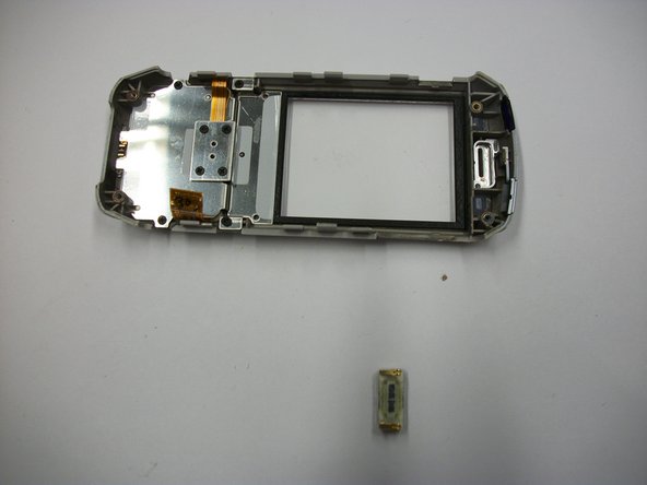

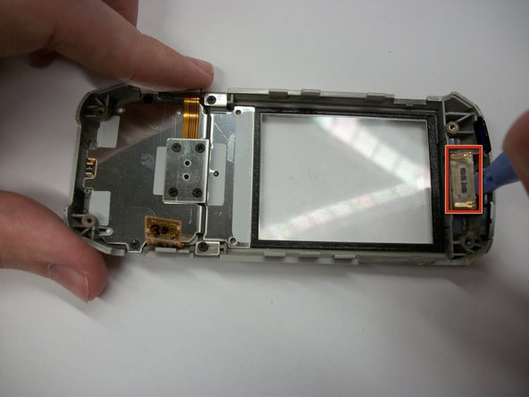

  7. T-Mobile SDA (HTC Tornado) Ear Speaker Replacement, Ear Speaker: crwdns2935265:07crwdnd2935265:01crwdnd2935265:03crwdne2935265:0 T-Mobile SDA (HTC Tornado) Ear Speaker Replacement, Ear Speaker: crwdns2935265:07crwdnd2935265:02crwdnd2935265:03crwdne2935265:0 T-Mobile SDA (HTC Tornado) Ear Speaker Replacement, Ear Speaker: crwdns2935265:07crwdnd2935265:03crwdnd2935265:03crwdne2935265:0
    • Lay the front faceplate face down on a flat surface.
    • While holding the bottom of the faceplate with one hand, use the plastic opening tool to gently pry the ear speaker from the top of the phone.
    • Completely remove the speaker from the phone and set it to the side.
    • The serial number on the back of the speaker can be used to find the correct replacement speaker.
