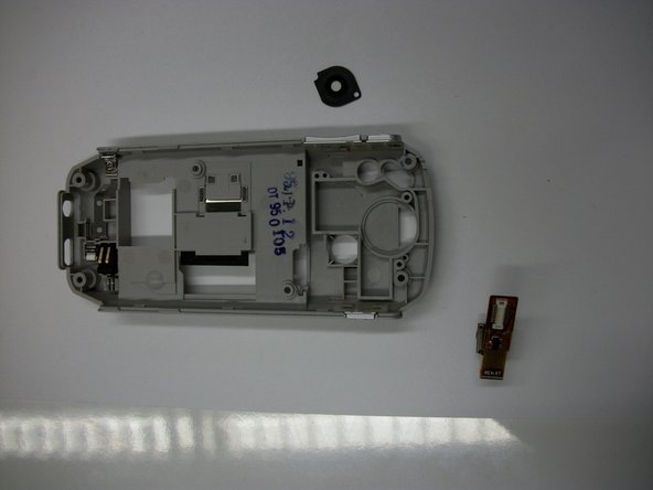

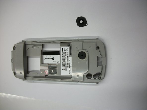

  6. T-Mobile SDA (HTC Tornado) Camera and Flash Replacement, Camera and Flash: crwdns2935265:06crwdnd2935265:01crwdnd2935265:03crwdne2935265:0 T-Mobile SDA (HTC Tornado) Camera and Flash Replacement, Camera and Flash: crwdns2935265:06crwdnd2935265:02crwdnd2935265:03crwdne2935265:0 T-Mobile SDA (HTC Tornado) Camera and Flash Replacement, Camera and Flash: crwdns2935265:06crwdnd2935265:03crwdnd2935265:03crwdne2935265:0
    • Use the plastic opening tool to gently pry off the lens cover and place it to the side.
    • Flip over the rear phone casing to view the flash compartment.

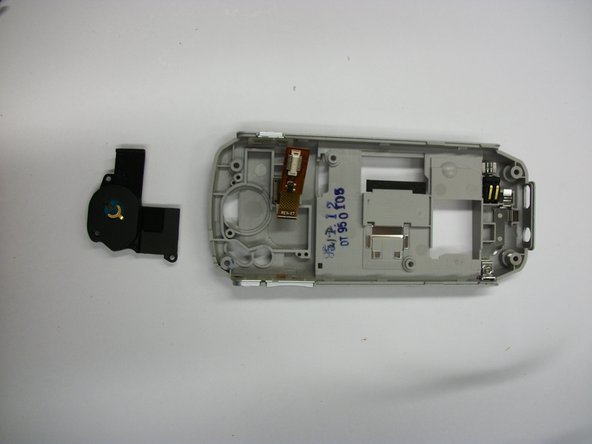

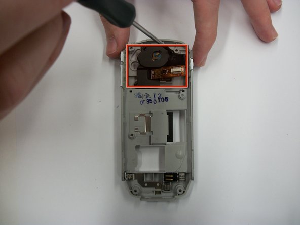

  7. T-Mobile SDA (HTC Tornado) Camera and Flash Replacement: crwdns2935265:07crwdnd2935265:01crwdnd2935265:03crwdne2935265:0 T-Mobile SDA (HTC Tornado) Camera and Flash Replacement: crwdns2935265:07crwdnd2935265:02crwdnd2935265:03crwdne2935265:0 T-Mobile SDA (HTC Tornado) Camera and Flash Replacement: crwdns2935265:07crwdnd2935265:03crwdnd2935265:03crwdne2935265:0
    • Unscrew the three black connecting screws.
    • Gently separate the copper connecting wire and the camera flash. Pull the camera flash out of the rear casing.
    • Carefully remove the camera by pulling on the copper connecting wire.
