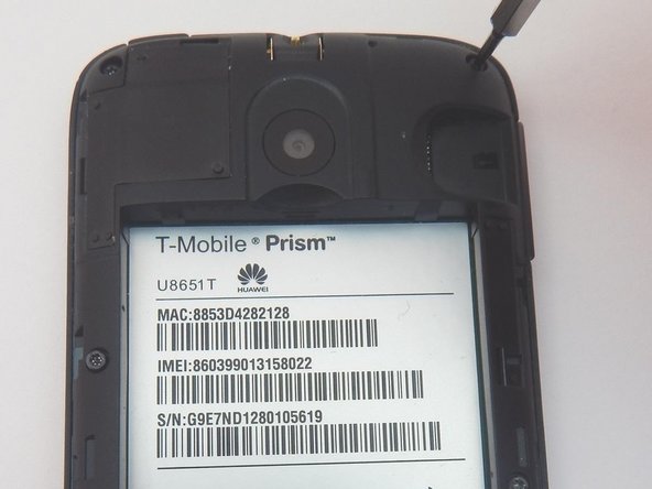

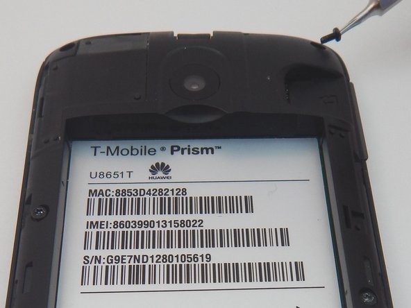

  3. T-Mobile Huawei Prism U8651T LCD Replacement, Torx Screws: crwdns2935265:03crwdnd2935265:01crwdnd2935265:03crwdne2935265:0 T-Mobile Huawei Prism U8651T LCD Replacement, Torx Screws: crwdns2935265:03crwdnd2935265:02crwdnd2935265:03crwdne2935265:0 T-Mobile Huawei Prism U8651T LCD Replacement, Torx Screws: crwdns2935265:03crwdnd2935265:03crwdnd2935265:03crwdne2935265:0
    • Locate the six 3mm torx screws holding the plastic mid frame in place.
    • Remove the six torx screws with the T4 torx screwdriver.

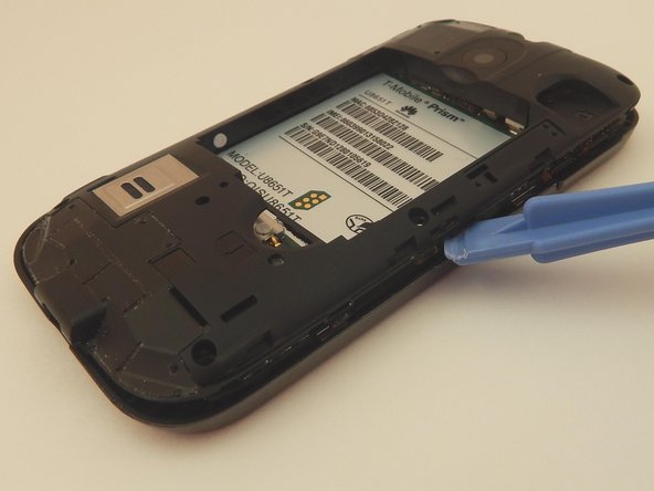

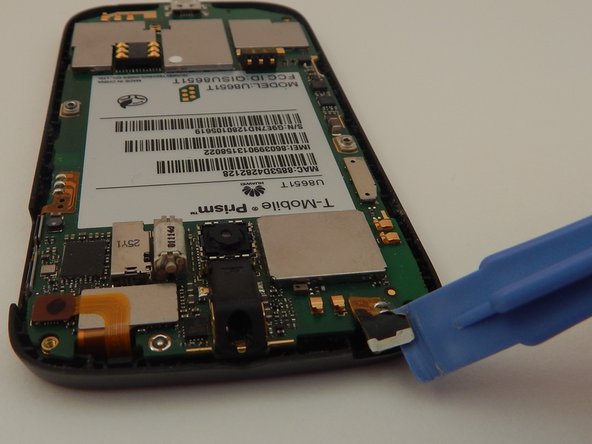

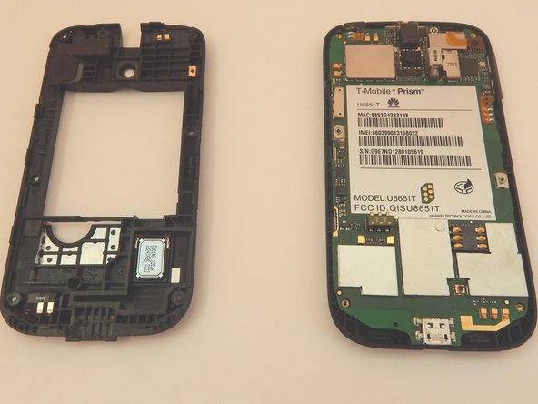

  4. T-Mobile Huawei Prism U8651T LCD Replacement, Remove Plastic Mid Frame: crwdns2935265:04crwdnd2935265:01crwdnd2935265:03crwdne2935265:0 T-Mobile Huawei Prism U8651T LCD Replacement, Remove Plastic Mid Frame: crwdns2935265:04crwdnd2935265:02crwdnd2935265:03crwdne2935265:0 T-Mobile Huawei Prism U8651T LCD Replacement, Remove Plastic Mid Frame: crwdns2935265:04crwdnd2935265:03crwdnd2935265:03crwdne2935265:0
    • Place the plastic opening tool in the charging port.
    • Pry up to loosen the bottom edge of the plastic mid frame.
    • Work the plastic opening tool along the seam, until the the plastic mid frame is detached.
    • Remove the plastic mid frame.

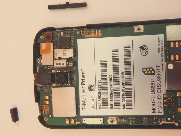

  5. T-Mobile Huawei Prism U8651T LCD Replacement, Remove Power and Volume Buttons: crwdns2935265:05crwdnd2935265:01crwdnd2935265:02crwdne2935265:0 T-Mobile Huawei Prism U8651T LCD Replacement, Remove Power and Volume Buttons: crwdns2935265:05crwdnd2935265:02crwdnd2935265:02crwdne2935265:0
    • Locate the power button.
    • Locate the volume botton.
    • Slide the two buttons up and out of the phone.
    • The removed buttons are incredibly easy to lose, so be sure to keep an eye on them.

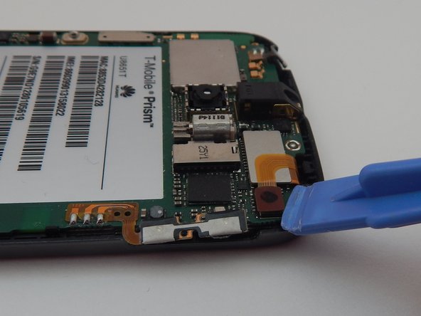

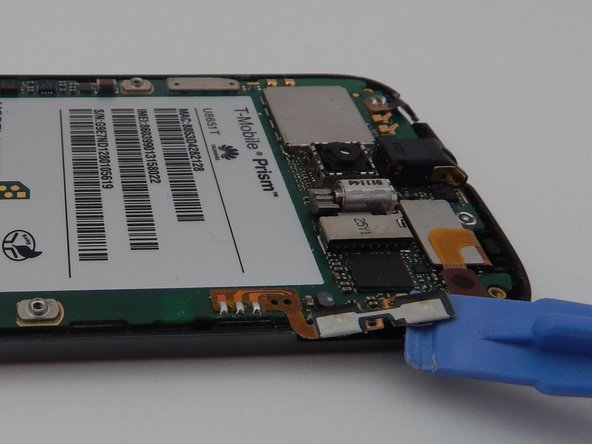

  6. T-Mobile Huawei Prism U8651T LCD Replacement, Remove Power Button Sensor Strip: crwdns2935265:06crwdnd2935265:01crwdnd2935265:03crwdne2935265:0 T-Mobile Huawei Prism U8651T LCD Replacement, Remove Power Button Sensor Strip: crwdns2935265:06crwdnd2935265:02crwdnd2935265:03crwdne2935265:0 T-Mobile Huawei Prism U8651T LCD Replacement, Remove Power Button Sensor Strip: crwdns2935265:06crwdnd2935265:03crwdnd2935265:03crwdne2935265:0
    • Locate the power button sensor strip.
    • Place the plastic opening tool under the sensor strip.
    • Pry the sensor strip up.
  7. T-Mobile Huawei Prism U8651T LCD Replacement, Remove Volume Button Sensor Strip: crwdns2935265:07crwdnd2935265:01crwdnd2935265:03crwdne2935265:0 T-Mobile Huawei Prism U8651T LCD Replacement, Remove Volume Button Sensor Strip: crwdns2935265:07crwdnd2935265:02crwdnd2935265:03crwdne2935265:0 T-Mobile Huawei Prism U8651T LCD Replacement, Remove Volume Button Sensor Strip: crwdns2935265:07crwdnd2935265:03crwdnd2935265:03crwdne2935265:0
    • Locate the volume button sensor strip.

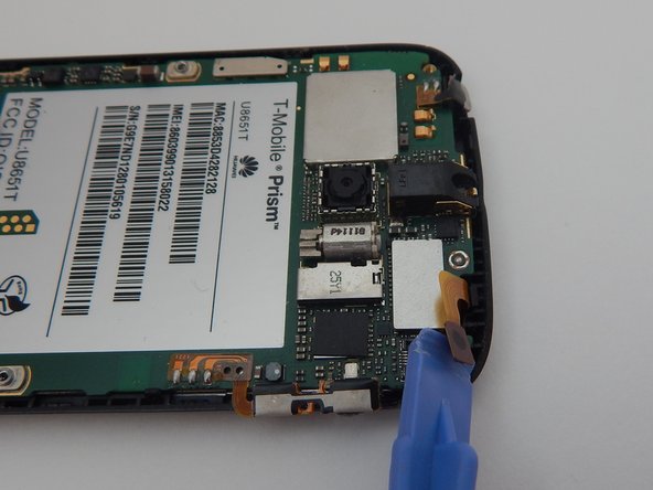

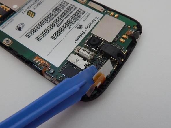

  8. T-Mobile Huawei Prism U8651T LCD Replacement, Remove Outer Screen Connector: crwdns2935265:08crwdnd2935265:01crwdnd2935265:03crwdne2935265:0 T-Mobile Huawei Prism U8651T LCD Replacement, Remove Outer Screen Connector: crwdns2935265:08crwdnd2935265:02crwdnd2935265:03crwdne2935265:0 T-Mobile Huawei Prism U8651T LCD Replacement, Remove Outer Screen Connector: crwdns2935265:08crwdnd2935265:03crwdnd2935265:03crwdne2935265:0
    • Locate the outer screen connector.
    • Place the plastic opening tool under the screen connector.
    • Pry the screen connector up.

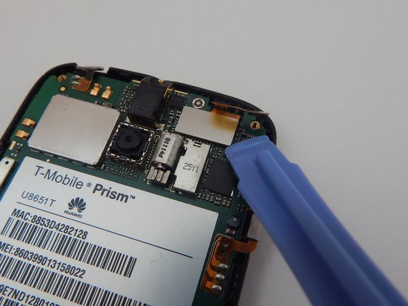

  9. T-Mobile Huawei Prism U8651T LCD Replacement, Remove Inner Screen Connector: crwdns2935265:09crwdnd2935265:01crwdnd2935265:03crwdne2935265:0 T-Mobile Huawei Prism U8651T LCD Replacement, Remove Inner Screen Connector: crwdns2935265:09crwdnd2935265:02crwdnd2935265:03crwdne2935265:0 T-Mobile Huawei Prism U8651T LCD Replacement, Remove Inner Screen Connector: crwdns2935265:09crwdnd2935265:03crwdnd2935265:03crwdne2935265:0
    • Locate the inner screen connector.

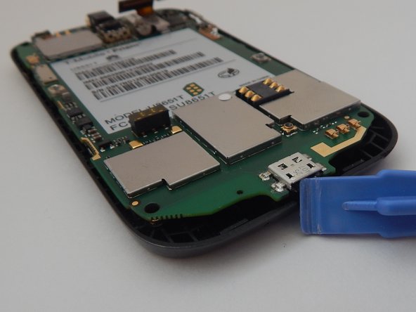

  10. T-Mobile Huawei Prism U8651T LCD Replacement, Remove Motherboard: crwdns2935265:010crwdnd2935265:01crwdnd2935265:03crwdne2935265:0 T-Mobile Huawei Prism U8651T LCD Replacement, Remove Motherboard: crwdns2935265:010crwdnd2935265:02crwdnd2935265:03crwdne2935265:0 T-Mobile Huawei Prism U8651T LCD Replacement, Remove Motherboard: crwdns2935265:010crwdnd2935265:03crwdnd2935265:03crwdne2935265:0

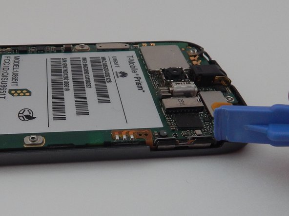

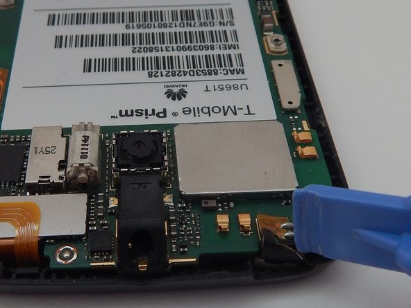

    • Place the plastic opening tool in the charger port.
    • Pry the motherboard up.
    • Remove the motherboard.

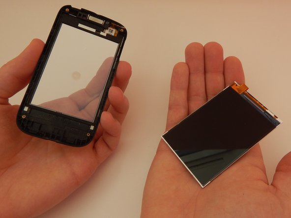

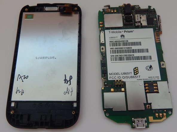

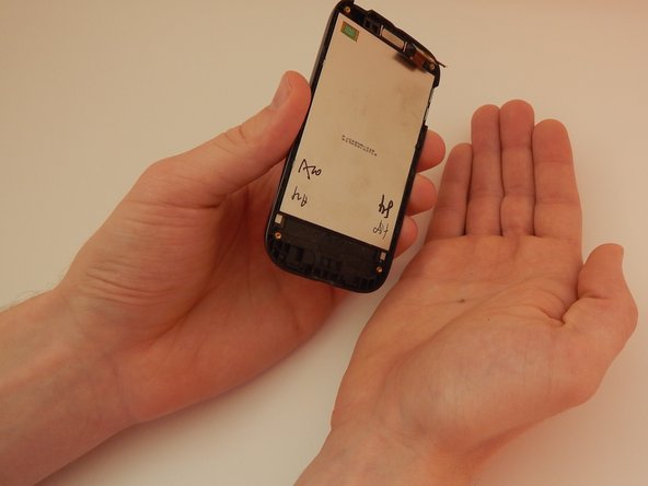

  11. T-Mobile Huawei Prism U8651T LCD Replacement, Remove Screen: crwdns2935265:011crwdnd2935265:01crwdnd2935265:03crwdne2935265:0 T-Mobile Huawei Prism U8651T LCD Replacement, Remove Screen: crwdns2935265:011crwdnd2935265:02crwdnd2935265:03crwdne2935265:0 T-Mobile Huawei Prism U8651T LCD Replacement, Remove Screen: crwdns2935265:011crwdnd2935265:03crwdnd2935265:03crwdne2935265:0
    • Pick up the front half of your phone with your left hand.
    • Slowly rotate the phone so the screen falls into your right hand.
    • Be extremely careful not to drop the screen.
