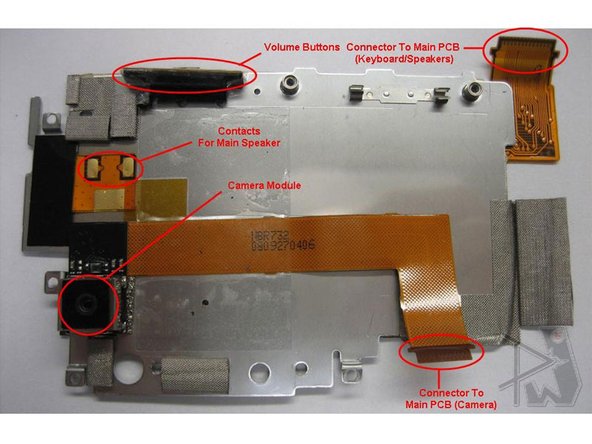

    • This part is pretty cool, because housed within the screen casing is four large parts.
    • On the front of the actual casing is the capacitive touch panels, with Synaptics handling the controllers and everything else touchscreen-related.
    • An interesting feature of this phone are the dual vibration motors. One motor is mounted on the display module, and the other on the main PCB.

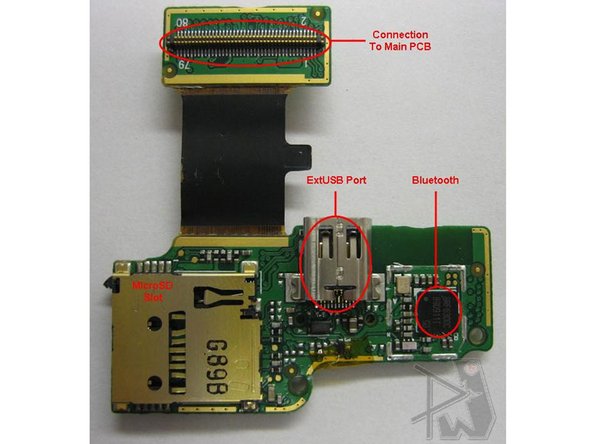

    • Lastly, we move on to the "chin" PCB.
    • Texas Instruments provides the Bluetooth and Wi-Fi chips, both appearing on this PCB.
    • The trackball is the same module used on nearly every BlackBerry (except the upgraded trackball found on the Javelin).
