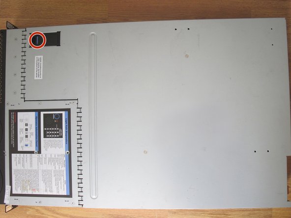

  1. System x3650 CPU and Memory Replacement, CPU and Memory: crwdns2935265:01crwdnd2935265:01crwdnd2935265:02crwdne2935265:0 System x3650 CPU and Memory Replacement, CPU and Memory: crwdns2935265:01crwdnd2935265:02crwdnd2935265:02crwdne2935265:0
    • Make sure that you have unplugged the power cable before servicing.
    • Pull the latch on the top cover up.
    • Slide the cover out.

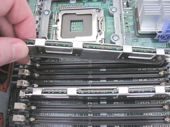

  5. System x3650 CPU and Memory Replacement: crwdns2935265:05crwdnd2935265:01crwdnd2935265:02crwdne2935265:0 System x3650 CPU and Memory Replacement: crwdns2935265:05crwdnd2935265:02crwdnd2935265:02crwdne2935265:0
    • Remove the old RAM if it is being replaced.
    • Unfasten the clamps on both ends of the slot.
    • Take out the memory module.
  6. System x3650 CPU and Memory Replacement: crwdns2935265:06crwdnd2935265:01crwdnd2935265:02crwdne2935265:0 System x3650 CPU and Memory Replacement: crwdns2935265:06crwdnd2935265:02crwdnd2935265:02crwdne2935265:0
    • Insert the new memory modules into the empty RAM slots securely.
    • The clamps on both ends of the slot should click into place.
    • See this link for the DIMM installation sequence.
