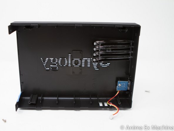

  4. Synology DS218play - a complete disassembly in rules, The two parts of the case: crwdns2935265:04crwdnd2935265:01crwdnd2935265:03crwdne2935265:0 Synology DS218play - a complete disassembly in rules, The two parts of the case: crwdns2935265:04crwdnd2935265:02crwdnd2935265:03crwdne2935265:0 Synology DS218play - a complete disassembly in rules, The two parts of the case: crwdns2935265:04crwdnd2935265:03crwdnd2935265:03crwdne2935265:0
    • Insérez ici votre traduction

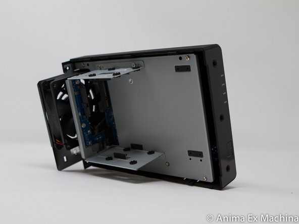

  5. Synology DS218play - a complete disassembly in rules, Removing the motherboard: crwdns2935265:05crwdnd2935265:01crwdnd2935265:03crwdne2935265:0 Synology DS218play - a complete disassembly in rules, Removing the motherboard: crwdns2935265:05crwdnd2935265:02crwdnd2935265:03crwdne2935265:0 Synology DS218play - a complete disassembly in rules, Removing the motherboard: crwdns2935265:05crwdnd2935265:03crwdnd2935265:03crwdne2935265:0
    • disconnect the fan cable
    • remove the 3 screws holding the motherboard in place.
