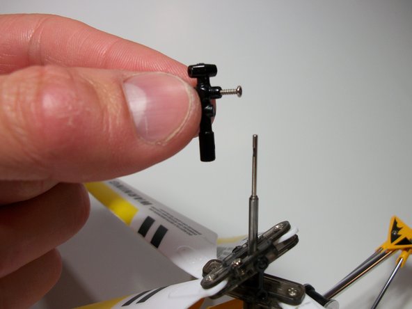

  2. Syma S107 Gyro Replacement: crwdns2935265:02crwdnd2935265:01crwdnd2935265:02crwdne2935265:0 Syma S107 Gyro Replacement: crwdns2935265:02crwdnd2935265:02crwdnd2935265:02crwdne2935265:0
    • Remove the counterweight bar by removing the screw.
    • One 10.1mm Phillips #0.

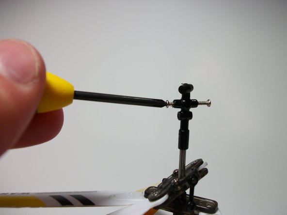

  3. Syma S107 Gyro Replacement, Gyro Carriage: crwdns2935265:03crwdnd2935265:01crwdnd2935265:02crwdne2935265:0 Syma S107 Gyro Replacement, Gyro Carriage: crwdns2935265:03crwdnd2935265:02crwdnd2935265:02crwdne2935265:0
    • Remove the gyro carriage by removing the following screws:
    • Two 5.6mm Phillips #0.
    • When reinstalling these screws make sure to line up one screw with the keyway on the main rotor shaft.

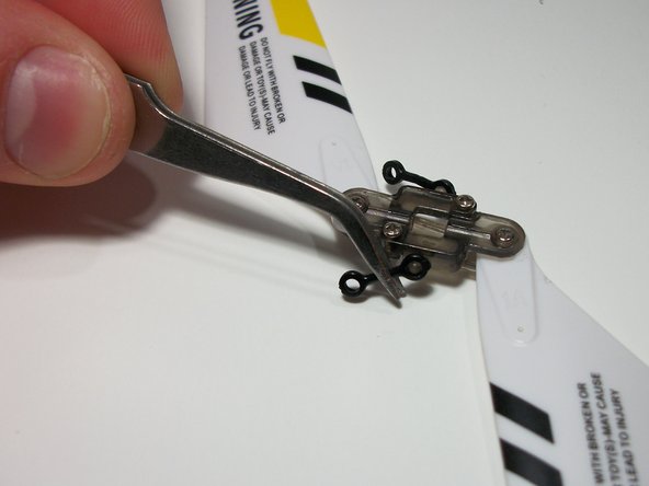

  5. Syma S107 Gyro Replacement, Blade Carriage: crwdns2935265:05crwdnd2935265:01crwdnd2935265:03crwdne2935265:0 Syma S107 Gyro Replacement, Blade Carriage: crwdns2935265:05crwdnd2935265:02crwdnd2935265:03crwdne2935265:0 Syma S107 Gyro Replacement, Blade Carriage: crwdns2935265:05crwdnd2935265:03crwdnd2935265:03crwdne2935265:0
    • Again using tweezers gently remove the stabilizing links from the blade carriage by pulling straight away from the point of connection.

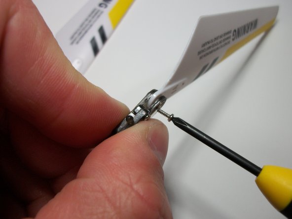

    • Remove the blades from the blade carriage by removing the following screws:
    • Two 4.7mm Phillips #0.

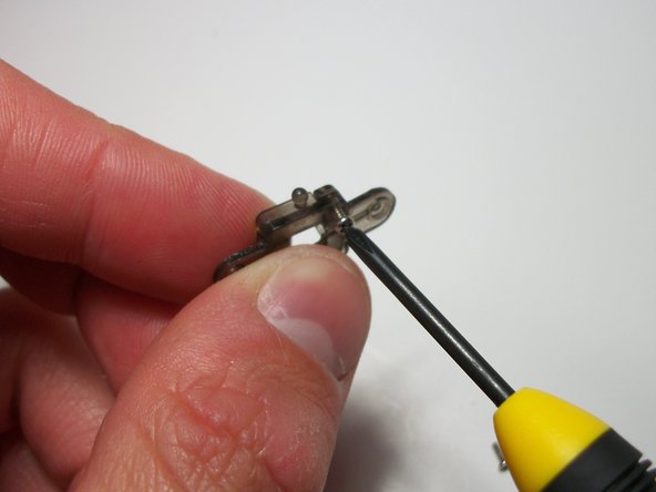

  7. Syma S107 Gyro Replacement: crwdns2935265:07crwdnd2935265:01crwdnd2935265:02crwdne2935265:0 Syma S107 Gyro Replacement: crwdns2935265:07crwdnd2935265:02crwdnd2935265:02crwdne2935265:0
    • Remove the following screws:
    • Two 4.5mm Phillips #0.
    • Make sure to remove any broken plastic pins before reassembling the components.
    • You will have to slide the two halves of the blade carriage over the pins on the gyro carriage first when reassembling.

I’m halfway there and grateful for the directions. But I’m not having any luck removing the broken plastic pins from the blade carriage. I’ve tried using a needle but no luck. Did anyone else come up against this?
