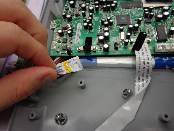

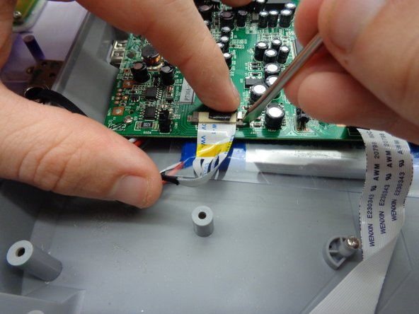

  4. Sylvania SDVD9004 Screen Replacement, Screen: crwdns2935265:04crwdnd2935265:01crwdnd2935265:03crwdne2935265:0 Sylvania SDVD9004 Screen Replacement, Screen: crwdns2935265:04crwdnd2935265:02crwdnd2935265:03crwdne2935265:0 Sylvania SDVD9004 Screen Replacement, Screen: crwdns2935265:04crwdnd2935265:03crwdnd2935265:03crwdne2935265:0
    • Disconnect ribbon
    • This guide uses incorrect tools. Use an ESD safe tool, such as a nylon spudger, to complete this step.
    • Rotate screwdriver to peel sticker from ribbon.
    • Place spudger head behind gray tabs on port.
    • Press outward to disengage tab.
    • Repeat on other side.
    • Slide out ribbon.
