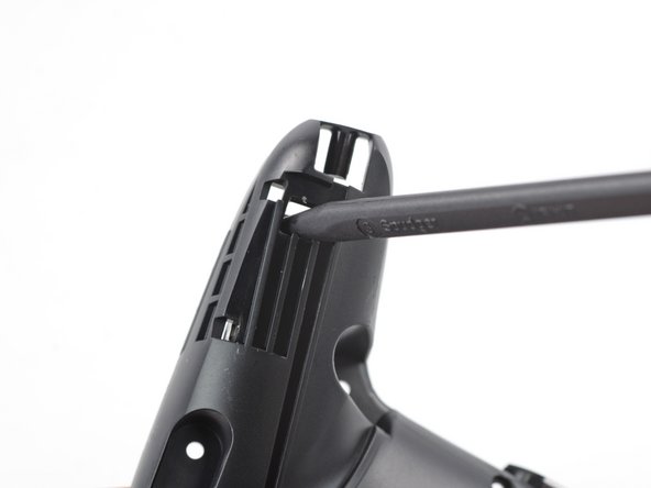

  13. Switch Pro Controller Motherboard Replacement, Loosen the adhesive: crwdns2935265:013crwdnd2935265:01crwdnd2935265:02crwdne2935265:0 Switch Pro Controller Motherboard Replacement, Loosen the adhesive: crwdns2935265:013crwdnd2935265:02crwdnd2935265:02crwdne2935265:0
    • Insert the tip of a spudger from the back into the hole on the right controller handle.
    • Push the spudger through the hole to loosen the adhesive which is holding rumble modules in their places.

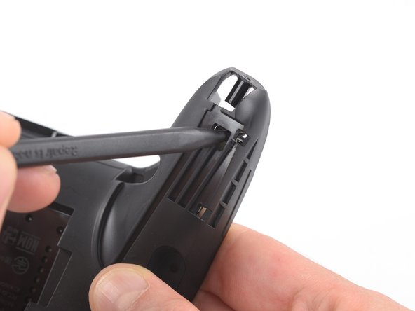

  14. Switch Pro Controller Motherboard Replacement, Loosen the adhesive: crwdns2935265:014crwdnd2935265:01crwdnd2935265:02crwdne2935265:0 Switch Pro Controller Motherboard Replacement, Loosen the adhesive: crwdns2935265:014crwdnd2935265:02crwdnd2935265:02crwdne2935265:0
    • Insert the tip of a spudger from the back into the hole on the left controller handle.

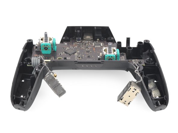

  15. Switch Pro Controller Motherboard Replacement, Lift the modules: crwdns2935265:015crwdnd2935265:01crwdnd2935265:02crwdne2935265:0 Switch Pro Controller Motherboard Replacement, Lift the modules: crwdns2935265:015crwdnd2935265:02crwdnd2935265:02crwdne2935265:0
    • Use a pair tweezers to lift the modules out of their places.
  16. Switch Pro Controller Motherboard Replacement, Unscrew the motherboard: crwdns2935265:016crwdnd2935265:01crwdnd2935265:01crwdne2935265:0
    • Use a Phillips screwdriver to remove the four 5 mm-long screws securing the motherboard.
  17. Switch Pro Controller Motherboard Replacement, Remove the LED light: crwdns2935265:017crwdnd2935265:01crwdnd2935265:03crwdne2935265:0 Switch Pro Controller Motherboard Replacement, Remove the LED light: crwdns2935265:017crwdnd2935265:02crwdnd2935265:03crwdne2935265:0 Switch Pro Controller Motherboard Replacement, Remove the LED light: crwdns2935265:017crwdnd2935265:03crwdnd2935265:03crwdne2935265:0
    • Use your thumb or a pair of tweezers to to take off the white LED light housing.
  18. Switch Pro Controller Motherboard Replacement, Lift the motherboard: crwdns2935265:018crwdnd2935265:01crwdnd2935265:03crwdne2935265:0 Switch Pro Controller Motherboard Replacement, Lift the motherboard: crwdns2935265:018crwdnd2935265:02crwdnd2935265:03crwdne2935265:0 Switch Pro Controller Motherboard Replacement, Lift the motherboard: crwdns2935265:018crwdnd2935265:03crwdnd2935265:03crwdne2935265:0
    • Lift the motherboard carefully as to not damage the wires and flip it to reveal the backside.

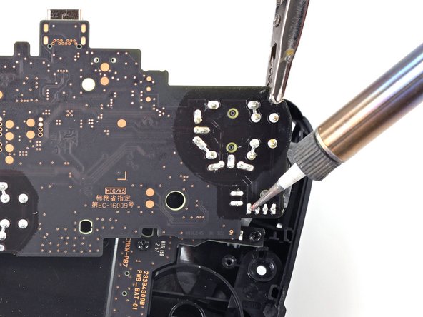

  19. Switch Pro Controller Motherboard Replacement, Desolder the rumble modules: crwdns2935265:019crwdnd2935265:01crwdnd2935265:03crwdne2935265:0 Switch Pro Controller Motherboard Replacement, Desolder the rumble modules: crwdns2935265:019crwdnd2935265:02crwdnd2935265:03crwdne2935265:0 Switch Pro Controller Motherboard Replacement, Desolder the rumble modules: crwdns2935265:019crwdnd2935265:03crwdnd2935265:03crwdne2935265:0
    • Desolder the rumble motor solder points on either side of the motherboard.
    • Remove the rumble modules.
    • Refer to the following solder guide if necessary: How to Solder
    • Solder the new rumble modules into the same pins.
  20. Switch Pro Controller Motherboard Replacement, Desolder the main power cable: crwdns2935265:020crwdnd2935265:01crwdnd2935265:02crwdne2935265:0 Switch Pro Controller Motherboard Replacement, Desolder the main power cable: crwdns2935265:020crwdnd2935265:02crwdnd2935265:02crwdne2935265:0
    • Remove the main power cable from the highlighted pins by de-soldering them.
    • Remove the motherboard.
    • Refer to the following solder guide if necessary: How to Solder.
