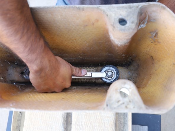

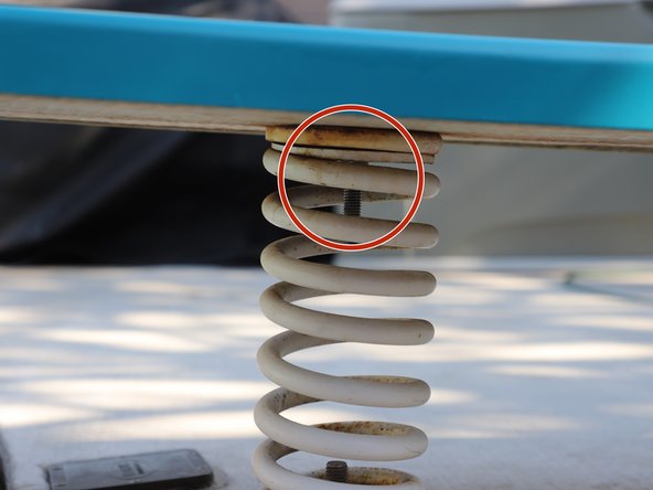

    • Using a ratchet, 5/16" Allen hex socket, and 3/4" box wrench, unscrew the fastener where the diving board meets the top of the spring.

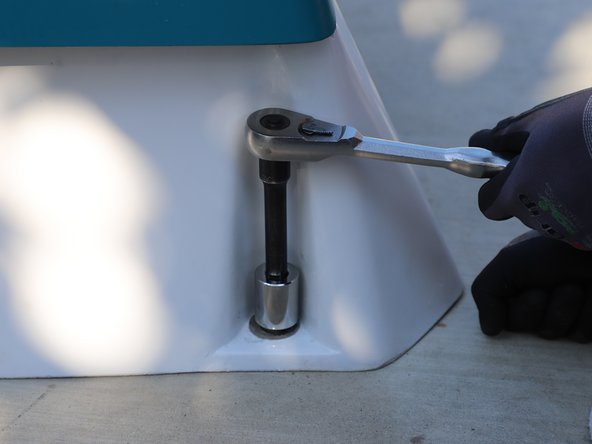

  2. Swimming Pool Diving Board Replacement: crwdns2935265:02crwdnd2935265:01crwdnd2935265:03crwdne2935265:0 Swimming Pool Diving Board Replacement: crwdns2935265:02crwdnd2935265:02crwdnd2935265:03crwdne2935265:0 Swimming Pool Diving Board Replacement: crwdns2935265:02crwdnd2935265:03crwdnd2935265:03crwdne2935265:0

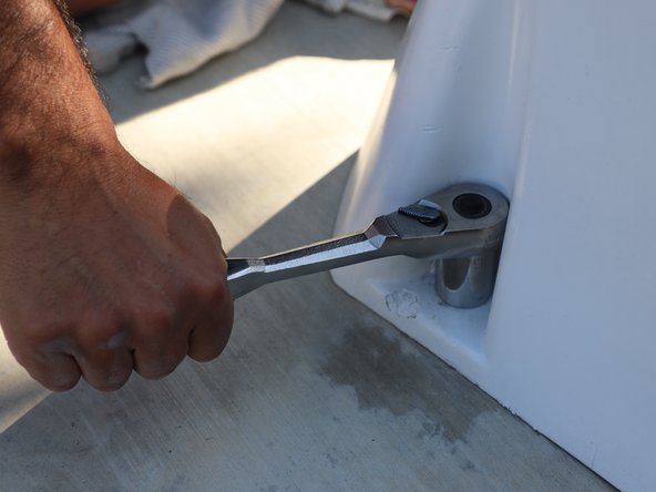

    • Use a ratchet and 15/16" short socket to unthread the 4 hex head fasteners from the fiber glass base.

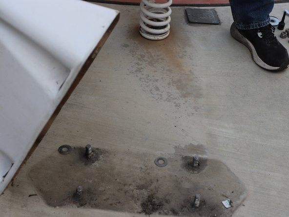

    • After 4 nylock hex head fasteners have been removed, lift the fiber glass base from the 4 threaded studs that are protruding from the concrete.

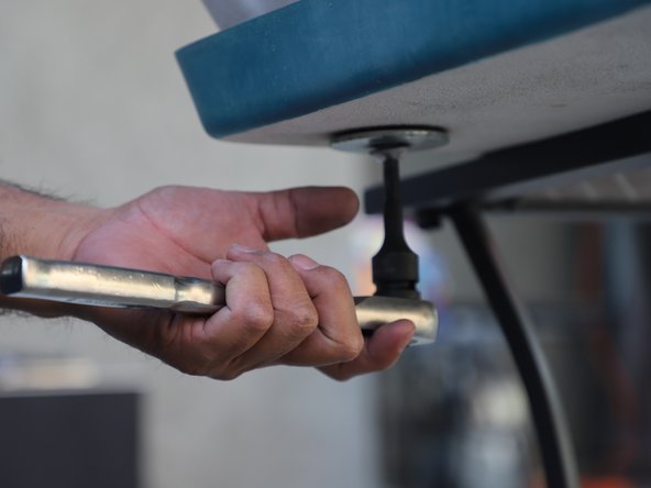

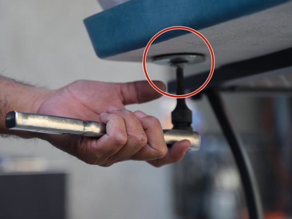

  4. Swimming Pool Diving Board Replacement: crwdns2935265:04crwdnd2935265:01crwdnd2935265:03crwdne2935265:0 Swimming Pool Diving Board Replacement: crwdns2935265:04crwdnd2935265:02crwdnd2935265:03crwdne2935265:0 Swimming Pool Diving Board Replacement: crwdns2935265:04crwdnd2935265:03crwdnd2935265:03crwdne2935265:0

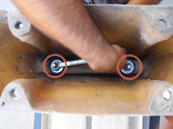

    • Remove 2 fasteners where the diving board meets the fiber glass base using the 5/16" Allen hex socket and the 3/4" hex nylock nut.
    • Set the base and board on a stable elevated surface like a table to make it easy to access the parts under the base.

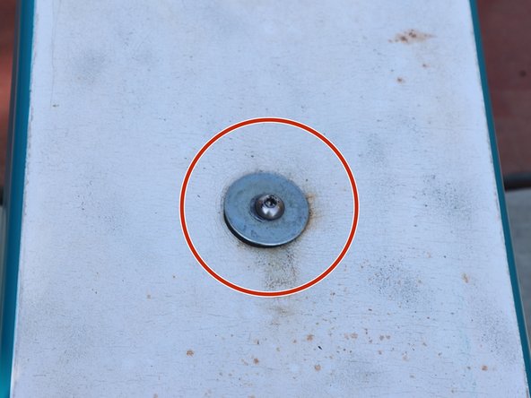

  5. Swimming Pool Diving Board Replacement: crwdns2935265:05crwdnd2935265:01crwdnd2935265:03crwdne2935265:0 Swimming Pool Diving Board Replacement: crwdns2935265:05crwdnd2935265:02crwdnd2935265:03crwdne2935265:0 Swimming Pool Diving Board Replacement: crwdns2935265:05crwdnd2935265:03crwdnd2935265:03crwdne2935265:0
    • To attach the new diving board, fasten the fiber glass base to the diving board using button head bolts, washers, gaskets, and nylock nuts.
    • Do not fasten the board to the fiber glass base too tightly as jumping on it while it is too tight can overload the diving board.

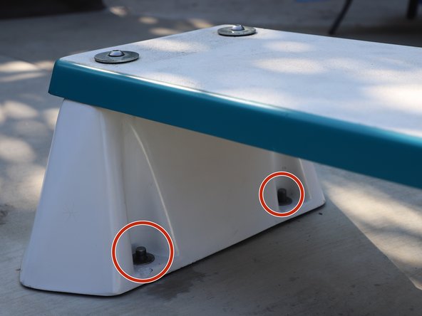

    • Mount the base with the new diving board back onto the 4 threaded studs protruding from the ground.

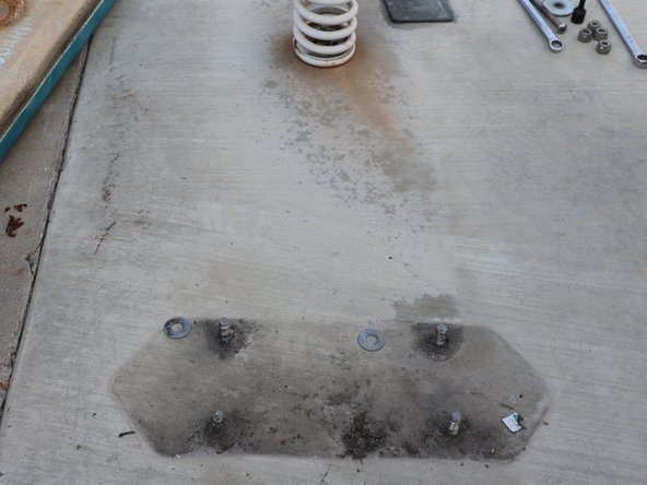

  7. Swimming Pool Diving Board Replacement: crwdns2935265:07crwdnd2935265:01crwdnd2935265:03crwdne2935265:0 Swimming Pool Diving Board Replacement: crwdns2935265:07crwdnd2935265:02crwdnd2935265:03crwdne2935265:0 Swimming Pool Diving Board Replacement: crwdns2935265:07crwdnd2935265:03crwdnd2935265:03crwdne2935265:0
    • Thread the 15/16" nylock nuts and washers onto stud anchors.

    • Using a ratchet, 5/16" Allen hex socket, and 3/4" box wrench, screw on the fastener where the diving board meets the top of the spring.
