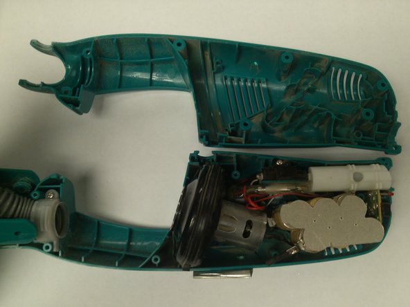

      • Unscrew seven 17.95 mm screws on the side of the device.
      • Unscrew the 13.87 mm screw.
    2. Swiffer SweeperVac Battery Replacement (PG3000): crwdns2935265:02crwdnd2935265:01crwdnd2935265:01crwdne2935265:0
      • Find the sticker on the back of the device. It may have already been removed.
      • If there is a sticker, peel it back from either half of the device.
    3. Swiffer SweeperVac Battery Replacement (PG3000): crwdns2935265:03crwdnd2935265:01crwdnd2935265:02crwdne2935265:0 Swiffer SweeperVac Battery Replacement (PG3000): crwdns2935265:03crwdnd2935265:02crwdnd2935265:02crwdne2935265:0
      • Firmly, but carefully grip each half of the case and split it open.
    4. Swiffer SweeperVac Battery Replacement (PG3000): crwdns2935265:04crwdnd2935265:01crwdnd2935265:01crwdne2935265:0
      • Remove the silver-colored battery cap from the top of the battery.
    5. Swiffer SweeperVac Battery Replacement (PG3000): crwdns2935265:05crwdnd2935265:01crwdnd2935265:01crwdne2935265:0
      • Lift the attached battery from the device and place it on the surface.
      • Remove the second silver-colored battery cap from the bottom of the interior of the device.
    6. Swiffer SweeperVac Battery Replacement (PG3000): crwdns2935265:06crwdnd2935265:01crwdnd2935265:01crwdne2935265:0
      • Using the spudger, apply pressure to the lock on the black wire attachment.
      • While pressure is being applied to the lock, pull the black wire away from the battery.
    7. Swiffer SweeperVac Battery Replacement (PG3000): crwdns2935265:07crwdnd2935265:01crwdnd2935265:02crwdne2935265:0 Swiffer SweeperVac Battery Replacement (PG3000): crwdns2935265:07crwdnd2935265:02crwdnd2935265:02crwdne2935265:0
      • Using the spudger, apply pressure to the lock on the red wire attachment.
      • While pressure is being applied to the lock, pull the red wire away from the battery.
      • When installing the new battery, you do not need to press down on the locks. Simply plug the wires into the appropriate sockets on the new battery.

This seems very easy. Will try amd make an update
eli3danimator - crwdns2934203:0crwdne2934203:0 crwdns2950251:0crwdne2950251:0
This was helpful but my swiffer vacuum had a plastic chassis for the battery and I had to remove the circuit board as well to route the wires on my replacement battery as they were not is the same places as the factory battery.

One place you can get the battery pack as shown is here; https://sweeperbattery.com/. The latest model (easier to install) battery in a case (6 cell - 7.2 volt) is also available from amazon.
