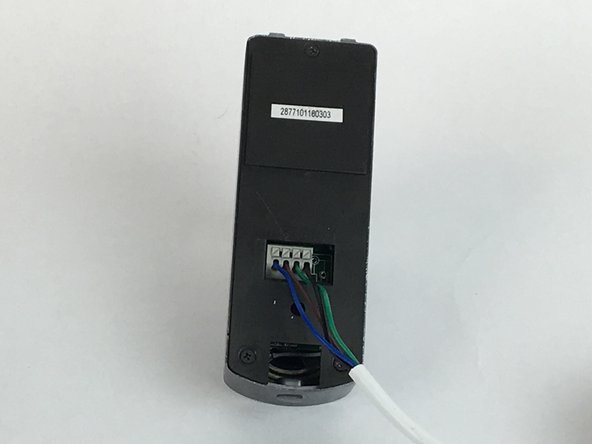

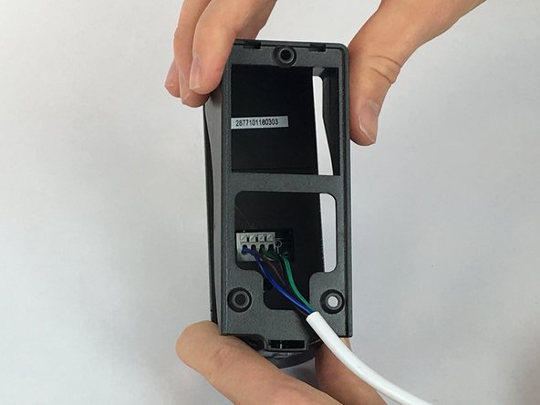

    3. Swann Doorphone Video Intercom Wire Replacement: crwdns2935265:03crwdnd2935265:01crwdnd2935265:03crwdne2935265:0 Swann Doorphone Video Intercom Wire Replacement: crwdns2935265:03crwdnd2935265:02crwdnd2935265:03crwdne2935265:0 Swann Doorphone Video Intercom Wire Replacement: crwdns2935265:03crwdnd2935265:03crwdnd2935265:03crwdne2935265:0
      • Flip the outdoor camera over so that the underside is facing up.
      • Remove the back cover by grabbing the sides of the camera and pulling towards your body.

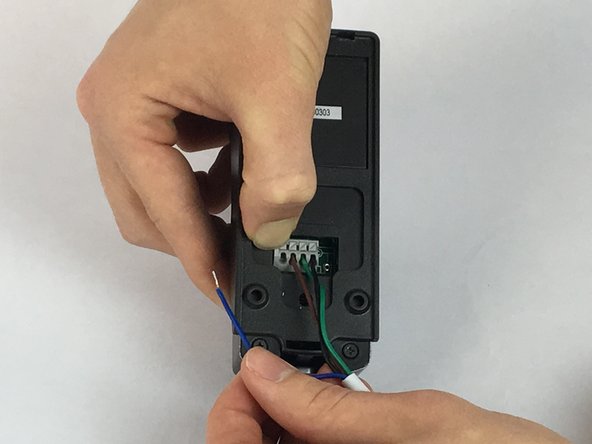

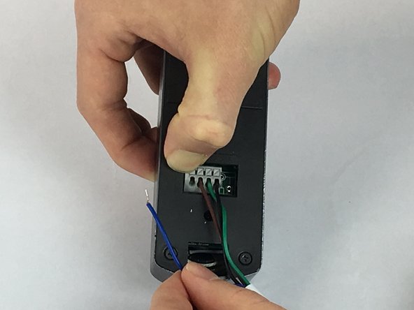

    4. Swann Doorphone Video Intercom Wire Replacement: crwdns2935265:04crwdnd2935265:01crwdnd2935265:03crwdne2935265:0 Swann Doorphone Video Intercom Wire Replacement: crwdns2935265:04crwdnd2935265:02crwdnd2935265:03crwdne2935265:0 Swann Doorphone Video Intercom Wire Replacement: crwdns2935265:04crwdnd2935265:03crwdnd2935265:03crwdne2935265:0
      • With the back cover of the outdoor camera off, press the first gray square button with blue wire down.
      • While pressing the gray square button, remove the blue wire from the first opening under the button.
      • Be sure to remove the same color wire for the outdoor camera as was used for the indoor video intercom.
      • In this guide, we are using the blue wire in terminal 1 for the audio. As a recommendation; * Use the blue wire in terminal 1 for the audio wire. * Use the brown wire in terminal 2 for the ground wire. * Use the green wire in terminal 3 for the video wire. * Use the black wire in terminal 4 for the power wire.
