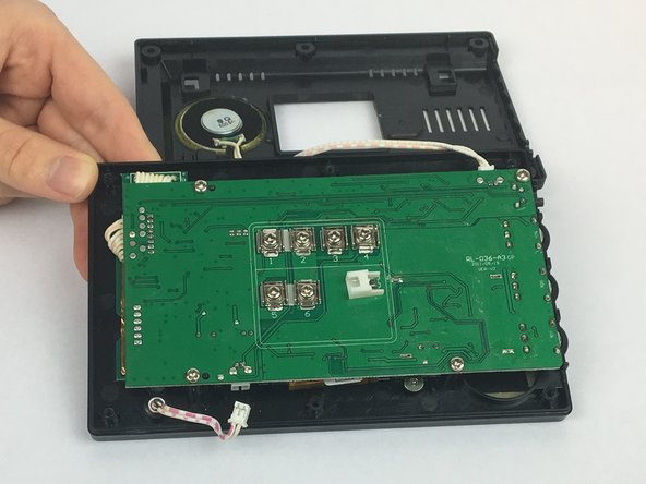

    • Flip the monitor of the Swann Doorphone Video Intercom over so that the underside is facing up.
    • Remove the six 2 mm corner screws from the back plate of the monitor using the JIS #0 screwdriver.

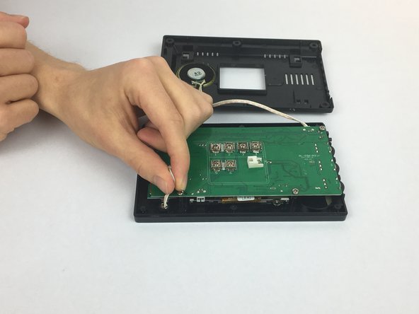

  2. Swann Doorphone Video Intercom Microphone Replacement: crwdns2935265:02crwdnd2935265:01crwdnd2935265:02crwdne2935265:0 Swann Doorphone Video Intercom Microphone Replacement: crwdns2935265:02crwdnd2935265:02crwdnd2935265:02crwdne2935265:0
    • Once the screws are removed, grip the black back plate of the monitor and remove from the monitor.
    • The back plate will still be connected to the monitor with a cord of wires that should not be removed.

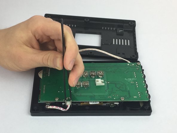

  3. Swann Doorphone Video Intercom Microphone Replacement: crwdns2935265:03crwdnd2935265:01crwdnd2935265:03crwdne2935265:0 Swann Doorphone Video Intercom Microphone Replacement: crwdns2935265:03crwdnd2935265:02crwdnd2935265:03crwdne2935265:0 Swann Doorphone Video Intercom Microphone Replacement: crwdns2935265:03crwdnd2935265:03crwdnd2935265:03crwdne2935265:0
    • Using the precision tweezers, grab the sides of the white connector at the bottom of the green board.
    • Pull the white connector towards you to disconnect the board.

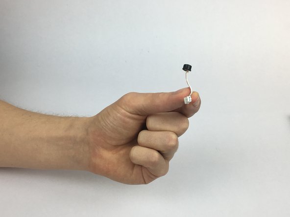

  4. Swann Doorphone Video Intercom Microphone Replacement: crwdns2935265:04crwdnd2935265:01crwdnd2935265:03crwdne2935265:0 Swann Doorphone Video Intercom Microphone Replacement: crwdns2935265:04crwdnd2935265:02crwdnd2935265:03crwdne2935265:0 Swann Doorphone Video Intercom Microphone Replacement: crwdns2935265:04crwdnd2935265:03crwdnd2935265:03crwdne2935265:0
    • Grip the other end of the white connector cable towards the base of the black microphone.
    • Pull gently towards your body to remove the microphone.
