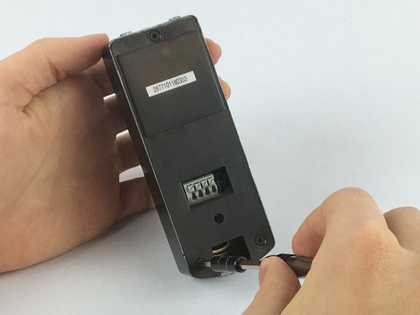

    • Flip the outdoor camera over so that the underside is facing up.
    • Remove the back cover by grabbing the sides of the camera and pulling towards your body.
  2. Swann Doorphone Video Intercom Doorbell Replacement: crwdns2935265:02crwdnd2935265:01crwdnd2935265:02crwdne2935265:0 Swann Doorphone Video Intercom Doorbell Replacement: crwdns2935265:02crwdnd2935265:02crwdnd2935265:02crwdne2935265:0
    • With the back cover of the outdoor camera off, press the first gray button, with blue wire underneath, down as shown in the picture.
    • While pressing the gray square button, remove the blue wire from the first opening under the button.
    • Be sure to remove the same color wire for the outdoor camera as was used for the indoor video intercom.
  3. Swann Doorphone Video Intercom Doorbell Replacement: crwdns2935265:03crwdnd2935265:01crwdnd2935265:03crwdne2935265:0 Swann Doorphone Video Intercom Doorbell Replacement: crwdns2935265:03crwdnd2935265:02crwdnd2935265:03crwdne2935265:0 Swann Doorphone Video Intercom Doorbell Replacement: crwdns2935265:03crwdnd2935265:03crwdnd2935265:03crwdne2935265:0
    • Remove the other wires using the same steps as the blue wire.
    • Using the JIS #0 screwdriver, remove the 2mm screws from the back plate.
    • Remove the back plate by pulling the plate away from the device.
  4. Swann Doorphone Video Intercom Doorbell Replacement: crwdns2935265:04crwdnd2935265:01crwdnd2935265:02crwdne2935265:0 Swann Doorphone Video Intercom Doorbell Replacement: crwdns2935265:04crwdnd2935265:02crwdnd2935265:02crwdne2935265:0
    • Using the JIS #0 screwdriver, remove the 1mm screws from behind the camera.
  5. Swann Doorphone Video Intercom Doorbell Replacement: crwdns2935265:05crwdnd2935265:01crwdnd2935265:02crwdne2935265:0 Swann Doorphone Video Intercom Doorbell Replacement: crwdns2935265:05crwdnd2935265:02crwdnd2935265:02crwdne2935265:0
    • Using one of the tweezers from the Precision Tweezers Set, gently place them around the wire connector attached to the camera.
    • Pull slowly in the direction of the cables until the connector is no longer attached.
  6. Swann Doorphone Video Intercom Doorbell Replacement: crwdns2935265:06crwdnd2935265:01crwdnd2935265:02crwdne2935265:0 Swann Doorphone Video Intercom Doorbell Replacement: crwdns2935265:06crwdnd2935265:02crwdnd2935265:02crwdne2935265:0

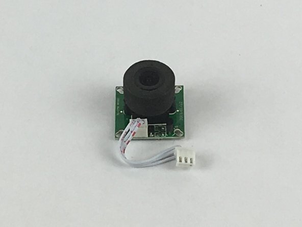

    • Remove the camera from the device.

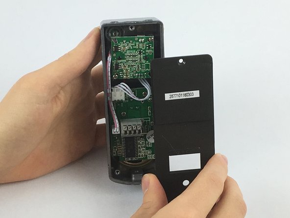

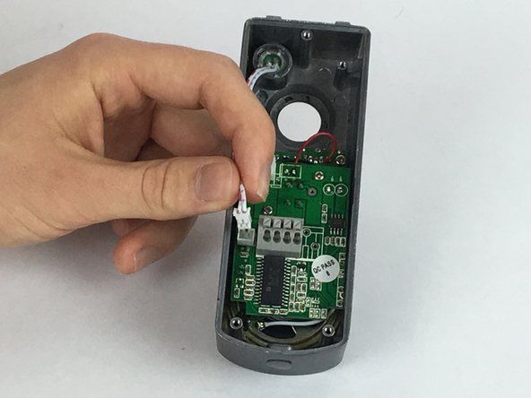

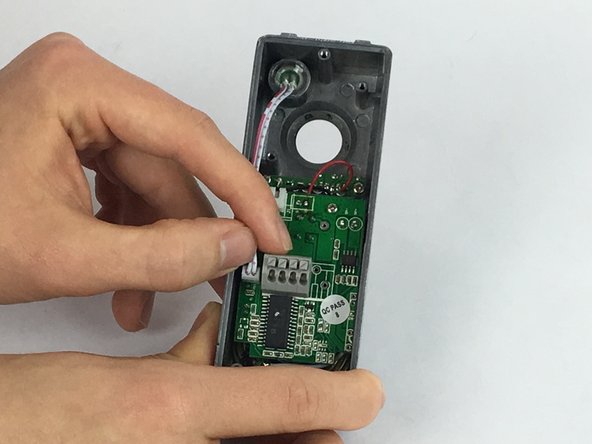

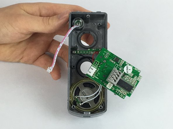

    • Using your fingers, take hold of the wire connector attached to the main board
    • Pull slowly towards your body until the connector is no longer attached.
  8. Swann Doorphone Video Intercom Doorbell Replacement: crwdns2935265:08crwdnd2935265:01crwdnd2935265:03crwdne2935265:0 Swann Doorphone Video Intercom Doorbell Replacement: crwdns2935265:08crwdnd2935265:02crwdnd2935265:03crwdne2935265:0 Swann Doorphone Video Intercom Doorbell Replacement: crwdns2935265:08crwdnd2935265:03crwdnd2935265:03crwdne2935265:0

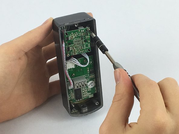

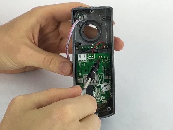

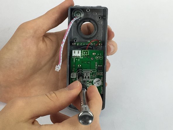

    • Using the JIS #0 screwdriver, remove the 2 mm screws diagonal from each other from the main board.

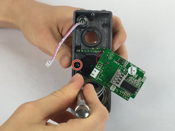

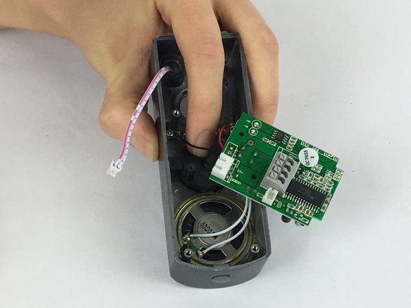

  9. Swann Doorphone Video Intercom Doorbell Replacement: crwdns2935265:09crwdnd2935265:01crwdnd2935265:02crwdne2935265:0 Swann Doorphone Video Intercom Doorbell Replacement: crwdns2935265:09crwdnd2935265:02crwdnd2935265:02crwdne2935265:0

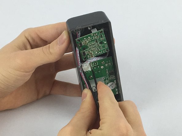

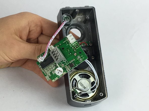

    • Gently pull the main board away from the inside of the device and leave to the side.
    • The main board will still be attached to the device by a remaining set of wires, but do not need to be removed.

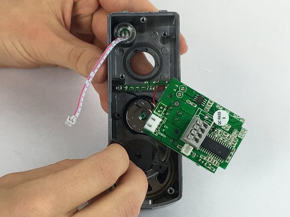

    • Using the JIS #0 screwdriver, remove the 1mm screws from each side of the doorbell spring-loaded cover-plate
    • While removing the second screw, hold down the cover-plate with your index finger to prevent the plate from springing out.
  11. Swann Doorphone Video Intercom Doorbell Replacement: crwdns2935265:011crwdnd2935265:01crwdnd2935265:03crwdne2935265:0 Swann Doorphone Video Intercom Doorbell Replacement: crwdns2935265:011crwdnd2935265:02crwdnd2935265:03crwdne2935265:0 Swann Doorphone Video Intercom Doorbell Replacement: crwdns2935265:011crwdnd2935265:03crwdnd2935265:03crwdne2935265:0
    • Remove the black circular doorbell cover-plate.
    • Remove the metal circular doorbell button.
