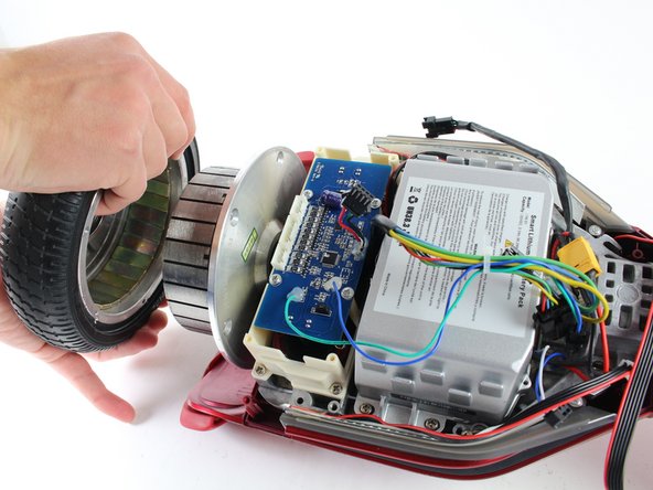

    1. Swagtron T3 Wheel Replacement, Wheel: crwdns2935265:03crwdnd2935265:01crwdnd2935265:01crwdne2935265:0
      • Unscrew the six 11.2 mm Phillips machine screws from the inside of the wheel.
      • You many need to spray a thin lubricant, such as PB Blaster, directly onto each of the six screw points to loosen them.
    2. Swagtron T3 Wheel Replacement: crwdns2935265:04crwdnd2935265:01crwdnd2935265:02crwdne2935265:0 Swagtron T3 Wheel Replacement: crwdns2935265:04crwdnd2935265:02crwdnd2935265:02crwdne2935265:0
      • Pull the wheel off of its base.
      • The wheel has a strong magnetic connection to the base, so separating the them will require a lot of force.

my girl Swagtron T6 wheel is flat. Probably it is a nail hole. We are faraway from US, so I have to do it by myself. Can I get the wheel out for tire repairing?
Can you help me please?

I have a T6 Swagtron and I am struggling to get the wheel off. Are these magnets really that strong? It feels like there is something else holding the wheel in place. I tried prying it but doesn’t seem like its doing enough.
