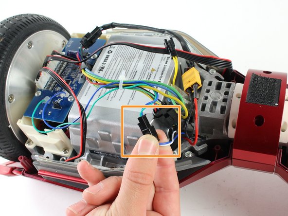

    3. Swagtron T3 Gyroscope Replacement: crwdns2935265:05crwdnd2935265:01crwdnd2935265:02crwdne2935265:0 Swagtron T3 Gyroscope Replacement: crwdns2935265:05crwdnd2935265:02crwdnd2935265:02crwdne2935265:0
      • Cut the plastic cable tie holding the cables together with utility scissors.
      • Disconnect the blue/green cable from the blue/white cable by pinching the connector clips and pulling the cables apart.
