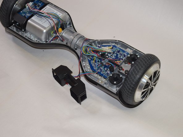

    3. SwagTron T1 Wheel Replacement: crwdns2935265:03crwdnd2935265:01crwdnd2935265:03crwdne2935265:0 SwagTron T1 Wheel Replacement: crwdns2935265:03crwdnd2935265:02crwdnd2935265:03crwdne2935265:0 SwagTron T1 Wheel Replacement: crwdns2935265:03crwdnd2935265:03crwdnd2935265:03crwdne2935265:0
      • Follow the wires from the panels to the motherboard.
      • You may need to cut any zip ties that are holding the wires together.
      • There is one connection on the battery side and three on the other side that must be removed.
      • These connections may be difficult to remove. Try to securely press the connection and pull firmly.
      • Your back panels are now completely removed.

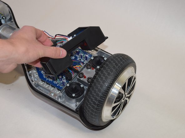

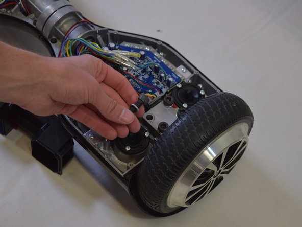

    1. SwagTron T1 Wheel Replacement, Wheel: crwdns2935265:04crwdnd2935265:01crwdnd2935265:03crwdne2935265:0 SwagTron T1 Wheel Replacement, Wheel: crwdns2935265:04crwdnd2935265:02crwdnd2935265:03crwdne2935265:0 SwagTron T1 Wheel Replacement, Wheel: crwdns2935265:04crwdnd2935265:03crwdnd2935265:03crwdne2935265:0
      • Using your Phillips #2 screwdriver, remove the four 1cm screws that attach the gyroscope and its black case to the hoverboard.
      • Carefully remove this component and set it off to the side.

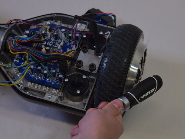

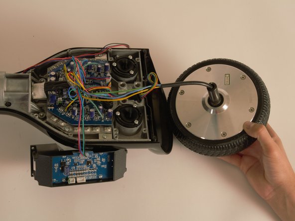

    2. SwagTron T1 Wheel Replacement: crwdns2935265:05crwdnd2935265:01crwdnd2935265:03crwdne2935265:0 SwagTron T1 Wheel Replacement: crwdns2935265:05crwdnd2935265:02crwdnd2935265:03crwdne2935265:0 SwagTron T1 Wheel Replacement: crwdns2935265:05crwdnd2935265:03crwdnd2935265:03crwdne2935265:0
      • Using your H 6.0 allen wrench, remove the four 20mm black bolts shown in the picture.
      • Take off the iron plate holding the wheel in place.
      • Remove the Motor/Wheel and set it aside close by to the hoverboard.
      • The wires from the Motor/Wheel should still be connected to the motherboard.
      • These bolts are very tight, it may be difficult to remove them. Try using a tool with a long handle.

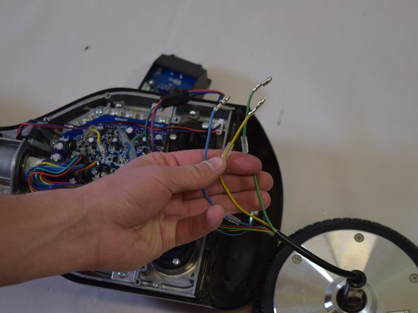

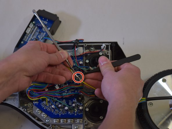

    3. SwagTron T1 Wheel Replacement: crwdns2935265:06crwdnd2935265:01crwdnd2935265:03crwdne2935265:0 SwagTron T1 Wheel Replacement: crwdns2935265:06crwdnd2935265:02crwdnd2935265:03crwdne2935265:0 SwagTron T1 Wheel Replacement: crwdns2935265:06crwdnd2935265:03crwdnd2935265:03crwdne2935265:0
      • Slide the protective plastic off the connectors on the marked wires (green, blue, and yellow) using your hands or a set of tweezers.
      • The connectors on the wires of your hoverboard may be different from those shown in the pictures on the left due to differences in manufacturing.
      • Separate the set of marked green, blue, and yellow wires from their connectors.

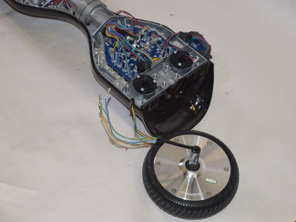

    4. SwagTron T1 Wheel Replacement: crwdns2935265:07crwdnd2935265:01crwdnd2935265:03crwdne2935265:0 SwagTron T1 Wheel Replacement: crwdns2935265:07crwdnd2935265:02crwdnd2935265:03crwdne2935265:0 SwagTron T1 Wheel Replacement: crwdns2935265:07crwdnd2935265:03crwdnd2935265:03crwdne2935265:0
      • Finally separate the last connector shown on the left.
      • Your wheel is completely removed; slide in a new Motor/Wheel into the slot and follow the previous steps in reverse order.
      • Make sure the replacement wheel is snug. Neither rubbing on the outer rim nor on the side of the hoverboard.
