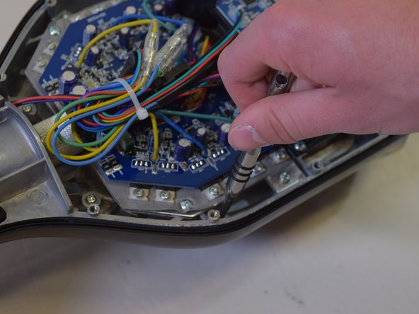

    • Ensure that the SwagTron is off.
    • Turn the SwagTron upside down to see the underside.
  2. SwagTron T1 Outer Shell Replacement: crwdns2935265:02crwdnd2935265:01crwdnd2935265:03crwdne2935265:0 SwagTron T1 Outer Shell Replacement: crwdns2935265:02crwdnd2935265:02crwdnd2935265:03crwdne2935265:0 SwagTron T1 Outer Shell Replacement: crwdns2935265:02crwdnd2935265:03crwdnd2935265:03crwdne2935265:0
    • Unscrew the eighteen 10mm screws that secure the back panels using a Phillips #2 screwdriver.
    • The screws are tightly in place. It will take effort to screw them out.
    • The panel is still attached to the SwagTron by wires that go to the motherboard.
    • Carefully lift the panels off
  3. SwagTron T1 Outer Shell Replacement: crwdns2935265:03crwdnd2935265:01crwdnd2935265:03crwdne2935265:0 SwagTron T1 Outer Shell Replacement: crwdns2935265:03crwdnd2935265:02crwdnd2935265:03crwdne2935265:0 SwagTron T1 Outer Shell Replacement: crwdns2935265:03crwdnd2935265:03crwdnd2935265:03crwdne2935265:0

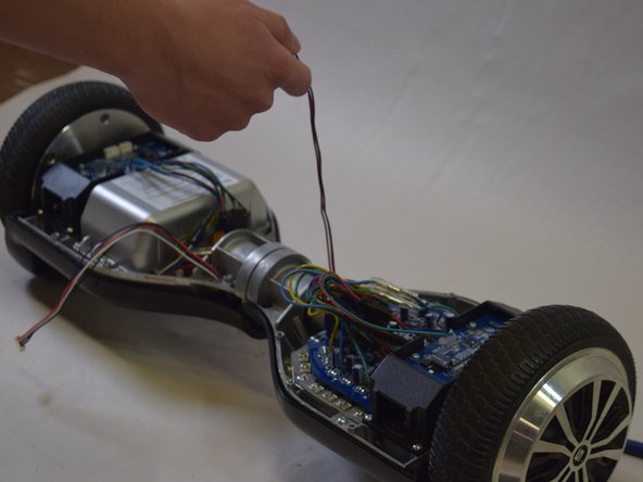

    • Follow the wires from the panels to the motherboard.
    • You may need to cut any zip ties that are holding the wires together.
    • There is one connection on the battery side and three on the other side that must be removed.
    • These connections may be difficult to remove. Try to securely press the connection and pull firmly.
    • Your back panels are now completely removed.

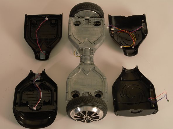

  5. SwagTron T1 Outer Shell Replacement: crwdns2935265:05crwdnd2935265:01crwdnd2935265:01crwdne2935265:0
    • Turn the SwagTron right side up and slightly lift up the panel.
    • Be careful to not pull too hard because the panel is still attached to the SwagTron by wires.
  6. SwagTron T1 Outer Shell Replacement: crwdns2935265:06crwdnd2935265:01crwdnd2935265:03crwdne2935265:0 SwagTron T1 Outer Shell Replacement: crwdns2935265:06crwdnd2935265:02crwdnd2935265:03crwdne2935265:0 SwagTron T1 Outer Shell Replacement: crwdns2935265:06crwdnd2935265:03crwdnd2935265:03crwdne2935265:0
    • Turn the SwagTron over and disconnect the wires from the motherboard.
    • Follow the wires to the underside of the SwagTron.
    • Carefully remove the cord and the panel together.
    • All the panels are now free from the SwagTron.
