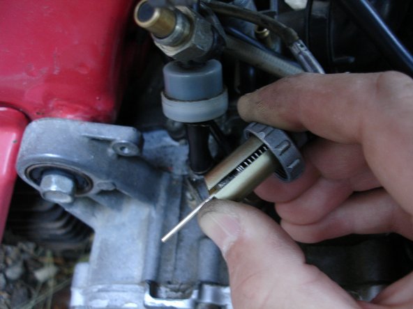

  1. Suzuki FA50 Moped Throttle Cable Teardown, Suzuki FA50 Moped Throttle Cable Teardown: crwdns2935265:01crwdnd2935265:01crwdnd2935265:01crwdne2935265:0
    • Here is the assembled throttle cable. It seems to be assembled correctly, but certainly does not function properly.

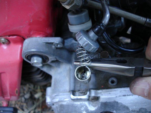

    • To assemble the throttle cable:
    • I first use a pair of needle-nose pliers to compress the spring as much as I can.
    • This allows me to insert the throttle cable into the gold-colored cylinder without having to meddle with the spring too much.
  5. Suzuki FA50 Moped Throttle Cable Teardown: crwdns2935265:05crwdnd2935265:01crwdnd2935265:02crwdne2935265:0 Suzuki FA50 Moped Throttle Cable Teardown: crwdns2935265:05crwdnd2935265:02crwdnd2935265:02crwdne2935265:0
    • I attach the throttle cable to the bottom of the gold cylinder and then route it through the cylinder's side slot.
    • The alternate view (picture 2) shows how everything looks internally.
    • After the throttle cable is in place, I let go of the spring into the cylinder.
  6. Suzuki FA50 Moped Throttle Cable Teardown: crwdns2935265:06crwdnd2935265:01crwdnd2935265:02crwdne2935265:0 Suzuki FA50 Moped Throttle Cable Teardown: crwdns2935265:06crwdnd2935265:02crwdnd2935265:02crwdne2935265:0

which way does you set the throttle when you put it in
ladell - crwdns2934203:0crwdne2934203:0
It appears to be correctly assembled however the cable isn't bottomed out on the cup to allow for free movement, I think you may have put a flat spot in to the cable itself that's not allowing the cup to bottom out on it and giving you the return movement.
