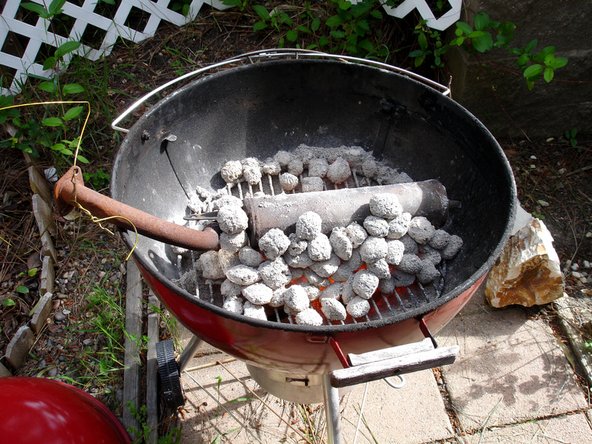

  5. Suzuki FA50 Moped Exhaust Cleaning: crwdns2935265:05crwdnd2935265:01crwdnd2935265:02crwdne2935265:0 Suzuki FA50 Moped Exhaust Cleaning: crwdns2935265:05crwdnd2935265:02crwdnd2935265:02crwdne2935265:0
    • Start a fire in a charcoal grill with about three layers of coals.
    • A charcoal grill is ideal here, because you will be laying the muffler directly onto the coals.

  7. Suzuki FA50 Moped Exhaust Cleaning: crwdns2935265:07crwdnd2935265:01crwdnd2935265:03crwdne2935265:0 Suzuki FA50 Moped Exhaust Cleaning: crwdns2935265:07crwdnd2935265:02crwdnd2935265:03crwdne2935265:0 Suzuki FA50 Moped Exhaust Cleaning: crwdns2935265:07crwdnd2935265:03crwdnd2935265:03crwdne2935265:0
    • Place the muffler on top of the coals, allowing the piping and flange to hang over the edge of the grill. Make sure the coals cover the sides of the muffler.

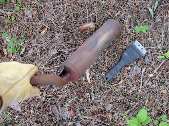

  8. Suzuki FA50 Moped Exhaust Cleaning: crwdns2935265:08crwdnd2935265:01crwdnd2935265:02crwdne2935265:0 Suzuki FA50 Moped Exhaust Cleaning: crwdns2935265:08crwdnd2935265:02crwdnd2935265:02crwdne2935265:0
    • Lay the muffler down on concrete for about an hour to cool.
    • Grab the exhaust pipe and shake the ash out of the muffler.
    • If you do not want to paint your muffler before reinstalling it, remove the plastic bag from the engine exhaust hole and follow steps 1-3 in reverse order to reassemble your moped.
    • Use an old barbecue wire brush or metal scraper to remove rust from the outside of the muffler and piping.

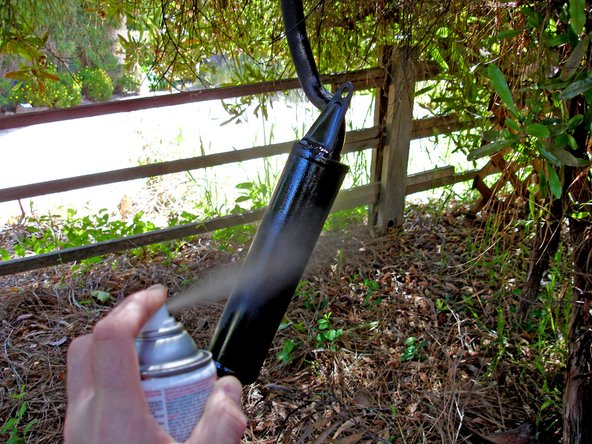

  9. Suzuki FA50 Moped Exhaust Cleaning: crwdns2935265:09crwdnd2935265:01crwdnd2935265:02crwdne2935265:0 Suzuki FA50 Moped Exhaust Cleaning: crwdns2935265:09crwdnd2935265:02crwdnd2935265:02crwdne2935265:0
    • Plug the hole in the exhaust pipe at the flange and hang the muffler in a place suitable for painting.
    • Use a high-termpeature paint like an engine or exhaust enamel to cover the entire exhaust pipe. Follow the specific instructions on your paint for drying times and suggested number of coats.

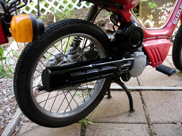

  10. Suzuki FA50 Moped Exhaust Cleaning: crwdns2935265:010crwdnd2935265:01crwdnd2935265:02crwdne2935265:0 Suzuki FA50 Moped Exhaust Cleaning: crwdns2935265:010crwdnd2935265:02crwdnd2935265:02crwdne2935265:0
    • Remove the plastic bag from the engine exhaust hole and follow steps 1-3 in reverse order to reassemble your moped.
    • Enjoy the new look and performance of your old exhaust!
